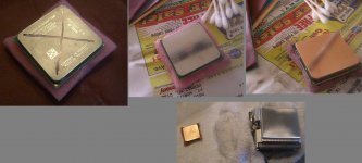

Thanks guys! I'll save my V20 for if I ever pick up another 5150, and I'll leave this one alone as-is. I can do some electronics work (see here) and I've lapped a few CPUs in my day during my "extreme PC" adventures (and they all still work to this day! also took my Pentium D to 4.1 GHz in '06 ). Swapping this 8088 seems like easy work. But that was a good way to put it: losing some earlier compatibility to gain some later capability.

Below: Kids, don't try this at home.
Click image for larger version  Name:	lapped_athlon.jpg Views:	0 Size:	147.8 KB ID:	1223484
