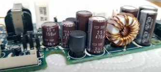

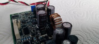

I'm sorry for bumping an old thread - but I've recently picked up a T1200 with a broken power-supply.
The previous owner attempted a repair himself and removed a few caps - before realising the repair was beyond his tools and ability. Unfortunately, this has left me without knowing the values of capacitors I need to fit in their place. I have noted someone in this thread mentioned the value of the two SMD tantalums - but no mention of the other capacitors.
I'm hoping someone might have recorded the values of each of the capacitors, so I can source and fit the correct parts.
C1-1800uf 10v
C2-1800uf 10v
C3-470uf 25v
C4-150uf 35v
C5-470uf 25v
C6-10uf 25v
C7-470uf 25v
?C8?-220uf 25v (one between C4 and C7)

Ah! Excellent. I can get those caps ordered without even opening mine up.
