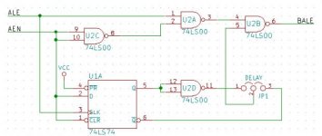

Here is what I came up with. Haven't tested it yet though:
It should work as follows:
- If AEN is low (inactive, no DMA operation), it supposed to pass the ALE signal through to BALE
- If ALE pulses while AEN is high, it will switch BALE to high, and keep it high as long as AEN remains high, and a little bit more. AEN low to BALE low delay can be set with the jumper.
(There is a question what circuit should do if ALE goes high first, after that AEN goes high, and after that ALE goes low... I am not sure if this situation can happen, but I don't think the circuit handles this case correctly).
I've prototyped and tested my circuit. It works nicely with original IBM PC, PC-Retro, and IBM XT boards. It also works with a chipset based XT clone and an AT/286 board.
Here is the schematic: View attachment xt_ale_fix.pdf. I uploaded the PCB design to OSH Park.
The PCB is designed in such a way that it can be glued on the bottom right corner of back side of the VGA card, and then GND, VCC, and ALE signals can be connected directly to the ISA edge connector. AEN and TALE (ALE to TVGA chip) would need to be wired to the board.

I implemented an easier approach - it only uses ALE and AEN signals.
I believe this approach is also more reliable. It doesn't change ALE (other than adding a slight delay) when AEN is inactive, and therefore it will not break AT systems. (Most likely Tronix's schematic will not work on an AT in 16-bit slot, because LA17-LA23 will not be valid when /MEMR or /MEMW are activated).
Some people reported ultra light solution - just pull up TVGA9000 ALE pin to +5V....
Huh, tested this on the boards I have available: IBM PC, IBM XT, PC-Retro, a chipset-based Turbo XT, 286-AT, and it works perfectly.
Apparently Trident TVGA has transparent latches on the address lines, tying ALE pin high keeps these latches in "transparent" mode, and it works as long as the address remains valid during I/O or memory operation.

Resistor is not needed (but won't hurt), just disconnect TVGA ALE pin from ISA, and connect it to +5V.

Yes, that makes the card work in IBM PC, IBM XT, and compatibles.
On my board, I put a piece of tape to cover the ALE pad on the ISA connector - 4th pad from the right, when looking at the back side of the board, and then I soldered a piece of wire between pin 19 (VCC) and pin 21 (ALE) of the TVGA9000I ICs:
