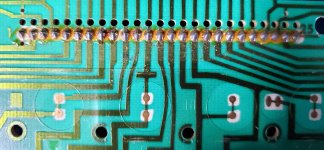

I think I have the issue resolved. First a thank you to retrogear as the diagram he provided was instrumental in troubleshooting this issue. With it I was able to use the OHM meter to determine there was no visible keyboard circuit board damage (which confirmed the visual inspection). Based on the meter testing I concluded the problem most likely was with the individual keys (even though a visual inspection didn't show any issues).

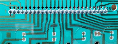

While performing the meter testing I was working on the solder side of the keyboard circuit board connector and notice it was extremely dirty with solder flux. Knowing the flux can cause issues when surrounding chip pins I decided to give it a clean with IPA. I grabbed a brush, dampened it with IPA, and lightly scrubbed away the flux. It cleaned up nicely and looked much better. While I had the IPA out I decided to clean each key pad a second time. I reattached the keys with the keyboard circuit board and gave it a try. All the keys appear to be working. I will need to install the keyboard assembly back into the case but it's very encouraging.
In conclusion the problem ended up being a lot of flux on the keyboard connector or a second cleaning of the key pads on the circuit board.
Before:

After:

You will probably never know...
But I always clean the flux off when I see things like that. It may have been ok when it was manufactured, but some fluxes can become conductive over time.
Nice job in cleaning it up though...
