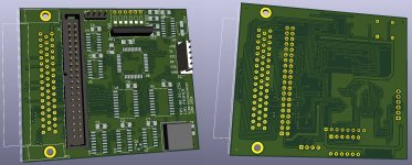

There's various bits of info re serial printing from the cassette port in TRS8BIT. Vol. 1 Issue 2 page 3, and Vol 7, issue 2 page28.
So LPRINT and LLIST will just "print" to the serial port. My main use for this will be for documenting my BASIC program listings - I'll be able to simply capture the output from the line printer commands with any decent terminal program on my PC.
.... but less so for bidirectional communication.
I have read on the internet that +5V was available at pin 3 of the Model 1's expansion port only on early versions of the main PCB. Is that true?
Forgot to mention that my design supports that in hardware too. On the read side at port 0x37E8, the PIC UART has command of the full data bus, not just the four printer status lines D4-D7. An open-drain I/O pin (RA4) of the PIC is wired to the expansion bus interrupt line. That provides a means of signalling to the computer that a received character is ready to be read at 0x37E8. The TRS-80 can signal back to the UART that it has copied the character simply by writing back to port 0x37E8, though that generally won't be necessary. For the RS-232 port I have implemented in hardware lines RTS, CTS, TX and RX and I have assigned two DIP switch positions for configuring the mode of operation. The basic line-printer mode (that I have shown here) is/will just be a dumb transmitter only on TX with no handshaking. The other three programmable modes are left available for whatever one-way or two-way communications protocols I may wish to implement in the future.

It cost nothing to connect an otherwise unused open-drain I/O pin of my PIC UART to the INT line.
I am going to have to further complicate my hardware with a latch to assert INT*. The latch will be set by the UART after each received a character, and will be cleared by RD*-0x37E8.

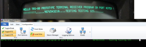

10 FOR X=1 TO 37: READ D: POKE 31743+X,D: NEXT X
20 DATA 237,86,62,195,50,18,64,33,19,124,34,19,64,251,201
30 DATA 243,201
40 DATA 0,128
50 DATA 229,197,33,232,55,78,42,17,124,113,35,34,17,124,193
60 DATA 225,251,201
100 REM -ENABLE ISR
110 POKE 16527,124: POKE 16526,0: A=USR(0)
200 CLS: REM -PRINT CHAR TO SCREEN
210 MP=PEEK(31761): IF MP=0 THEN 210
220 B1=PEEK(31761): B2=PEEK(31762)
230 MS=B1+(B2*256)-1
240 CH=PEEK(-(65536-MS)): PRINT CHR$(CH);
250 M=PEEK(31761): IF M=MP THEN 250
260 MP=M: GOTO 220
