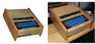

She is finally in her case. I don't know how I could be almost 1/2 inch longer than the prototype and still have everything be this tight -- but it is! And man, is it heavy! I did not expect it to be that heavy!
I didn't really think about how I was going to place the ASCII encoder in the case. I didn't give it quite enough leash to tuck it up the side away from the power supply, and it sticks out from the bottom anyway. So I used some electrical tape for now to suspend it from the rear of the memory board.
Another oddity is when the unit is laid flat, the cursor control develops a problem where it skips lines as you type. When I have the unit on it's side it's fine.
Anyway, I managed to type out my magazine cover message one more time!

I decided for now to print off my TVT badges on an inkjet. I'm actually surprised at how nice they came out. Here's a few snaps including a side by side:
And side by side with original on left:
All in all, I can't be too displeased. When I started, I had no skills working with wood, or building anything electronic. To have something that looks pretty darn close to the original (if I say so myself) is pretty satisfying. And unlike the original, it actually works!
If I find out that the badges on the original are metal I will consider ordering a set from a professional shop somewhere. But after handling my printed labels, I honestly can't really tell the difference.
