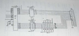

ETV300
The document is intended as a description of the hardware units in 1983.
The case is very similar to a classic pc deskot modern. Its front presenting a drive 5.25", a led power indicator and a reset button. On the back there is a power switch at its side there is a grip for the input of 220Vac. There is a 9-pin female cannon connector with power and signal for monochrome external CRT monitor, a parallel port and a serial port RS-232 standard both attested on a cannon 25-pin female. They are distinct one from the another for a pin present on the outside of the connector positioned differently in order to prevent a cable is inserted in place of the serial to parallel and viceversa.
The internal power supply has a 220Vac input and a connector for output DC voltages. A little printed circuit board connected to 220Vac hosts connections for internal power supplies: two connectors for power cables floppy drive, along with connectors for power the main pcb and an additional connector for a small PCB whose output connector has a power cable connector to CRT.
The main pcb OLIVETTI XS AB RL13LC has three card edge 25 + 25 connectors and a male one always with 25 + 25 contacts for further extensions. The quartz for the clock is 8MHz. It has a Z80 CPU, a CTC Z80, 2 eprom 2716, a 64KB (8x4164) memory bank, one Z80 PIO and one Z80DART. Above the Z80DART there is a small PCB with chip SN75188 / 89 which convert signals from TTL to RS232 standard. The signals wired on cannon 25-pin female are pins: 2,3,4,5,6,7,8,9,10,12,13 and 20. The parallel port has the following pin wired: 1,2,4 , 5,6,7,8,9,14,15,16,17,18,19,20,21,22. On the main board near the power connector there is a 4-pin DIP switch to configure the likely presence or absence of additional cards in the slots.
The monochrome video card produced by FACE teleinformatica reports the code XSCRTC LSRL02 and it has a chip TMS9937NL, two DRAM 6116, a chip CRT8002 and an EPROM 2732. the video output is taken via a chip SN7486 known to allow reverse sync signals appropriately managed through separate a dip switch 4 pin and a jumper to 2 positions. The connector has the 1,3,5,7 grounded and signals are present separate sync and video signals on pins 2,4,6,8.
The board FDC produced by FACE teleinformatica si reports the code XSMFDC LS RL01 and it has a chip Z80 PIO, a WD1793 and a standard 34-pin connector for flat cables for floppy disk drive.
The floppy drive is a FDD2124AM2 the ALPS with formatted capacity of 180KByte (SS / DD
MANUFACTURER MODEL NO. WDTH. HGT. UNFMT'D FORMT'D RPM
ALPS ELEC. FDD2124 5.25 HALF 250KB 180KB 300
The flat cable is modified: all pins except the following are given straight from IDC female connector to the two card edge connectors female:
IDC pin 1 --- pin 1 of 1st card edge
IDC pin 3 --- pin 1 of the 2nd card edge
IDC pin 15 --- pin16 of the 2nd card edge
Power Connector pins
Black to pin 4 of SN74121
white GND
Blue + 12Vdc
white GND
white GND
Red + 5Vdc
Red + 5Vdc
white GND
Green to contact A21 connector BUS
orange -12Vdc
