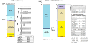

My colorized address map for the 4051 versus 4052/4054 is from the service manuals.
Since the top address of the 8K ROM Switchable Bank is A800 - that implies the beginning of the 8K switchable bank is 8800.
The table below the 4051 Peripheral Control Addresses lists the beginning and end of each range:
  • 8000 to 877F is part of the BASIC ROM
  • 8780 to 87FF is memory mapped I/O addresses including the bank switch registers
  • 8800 to A7FF is the 8K ROM switchable bank address range
