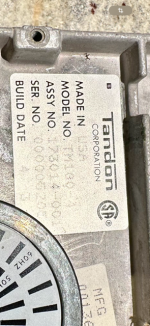

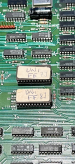

I have disassembled the Victor tonight.
Please have a look at the pictures, The Floppy Drive is a Tandon TM100-4, the HDD is a Miniscribe III, Mod. 3012.
Please also have a look at the Boot ROMs, seems they aren't original anymore (?)
I have also attached pictures of the Drive Controller, HDD Controller and Main Board, any comments are highly appreciated, also hints what to do next.

The Victor 9000 Universal Boot ROMs were an update that allowed the system to booth from floppy, hard disk, or network. You can get more detailed information on page 234 of this document. Copies of these ROMs became readily available though Victor User groups and many people installed them into their systems. These are probably the best ROMs for your system.

Thanks for posting photos Martin. That all looks like the standard kit, in quite good condition. I agree your ROMs have likely been upgraded. Those look like the "Universal ROMs." They're described in the Dealer Guide as:
SUBJECT: UNIVERSAL BOOT PROMS [P/N 106168-01, FE (5H) and P/N 106170-01,
New eproms have been developed which allow the mainframe to load a bootstrap from either the floppy or the 10 MB hard disk, or the network, if so equipped. Universal Boot Proms also provide a diagnostic routine which loops the 8088 if a hardware error is encountered during the boot.
A system equipped with Unversal Boot Proms will display different icons during the boot. The memory test symbol M will appear, followed by the memory size in Kilo-bytes. The device (and device number) that is being polled for the bootstrap is displayed, and a new icon for the network will appear if a network board is installed on the mainframe.
