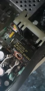

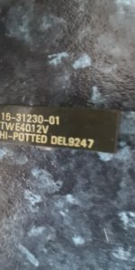

Hi Dave, I'm Paul.:) I've removed and cleaned the circuit board. I found the top of transformer T802 inside the terminal. Not 100% sure if this transformer has blew. I'll remove it from PCB at the weekend and check for open circuits and shorts. I took some photos but I'm having problems uploading them due to size being too large.

My experience is that it is very unlikely that transformer goes bad. With the exception of one FBT I had no transformer going bad at all. When the PSU ticks it is very likely that it tries to start up but discover some kind of situation that causes it to turn off immediately. Over current situation is in my experience most common source. That could be the load itself or faulty output rectifiers.
Check all the output rectifiers. Disconnect the load and use a proper dummy load. Some PSU don't like to have uneven load. Depending on how the regulation is done uneven load could cause crowbar circuit to trap and then there is over current situation as a result. In this case I cannot see any crowbar in the circuit. It seems to regulate on the sum of the 41V and 5V.
Could be an electrolytic cap that is bad, but have yet to see an electrolytic go short circuit, more often I have seen them go open circuit or low capacitance. Tantalum capacitors on the other hand is a completely different story.
I had a VT420 that was ticking like this and I spent a lot of time looking at the secondary side but couldn't find anything wrong. The problem turned out to be the transformer but not in the way that you might expect. There was a tiny break in one of the windings where is goes from the post on the PCB into the coil. It was the one on the primary side that supplies power to the UC3842 control circuitry. Enough power was being supplied by the startup resistor R804 to get the PSU going but of course not enough to keep it running. VCC on the UC3842 would quickly drop, the PSU would shutdown, VCC would come back up and the cycle repeated. I managed to resolder the winding back on to the post. I don't think this is a common problem but it's something to watch out for.
Don’t like the looks of that, maybe one of the diodes had shorted on the secondary side and somehow it did not shut down and burnt up the transformer? If anything went bad on the primary side like the FET failing or shorted diodes or what ever on that side would have thought the fuse would blow. Maybe that was just a transformer built on a Monday morning or Friday afternoon? You very rarely see a transformer fail in a switching supply without something causing it. I have never seen one fail without an external cause like a short on the secondary side.
Don’t know if T802 is different for the 220 volt version from the US version that runs at 120 volts. Lot more voltage available to the transformer on the export version and if they used the same transformer maybe the EU versions are more prone to insulation break down? Today we take it for granted that most switching power supplies will work from 100 to 250 volts without issue but back when they were built don’t know if the inputs were that robust. They did go with a higher working voltage filter capacitor and maybe a couple other small changes on the 220 volt version verse the 120 volt version.
