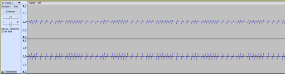

Probably, but it reads back normal tapes fine. I was looking over the full signal it recorded and let's say it's not perfect. I could see multiple points where the recording into Audacity was so close to nothing that I can't fault the machine for not reading it properly.It could be that the head characteristics are different than the original.
Well... you mentioning this gets me thinking... what about the resistors in the cassette adapter? What if those were changed to allow a stronger signal to exit the adapter? There is a little PCB in the cassette adapter with 4 resistors on it, 2 per channel... looks like 3200 Ohms if I'm reading them right.It's possible that the record mode is not optimal for the head. If we knew things like how much flux per milliamp (or however they measure that), we might be able to tune the series resistor (6.4K in your case) to send more current through the head during record. But, you don't want to burn out the head, either.
No, I was doing a quick test loading the test data of 200 "0" that I wrote to tape last weekend into the machine, then switching the real tape out for the cassette adapter and try to record the signal into Audacity on a laptop through the microphone jack.Oh, I thought you were using real tape. If you are feeding a signal through the adapter, then it is certainly possible that the signal is too weak.

Ah, I had not thought about that. But it does make sense. There is only one way to install the tape head, but I could check the wiring. I was thinking about a change in either the inductive of capacitive properties of the head... but an inverted signal makes a lot more sense.The traces might be more alike than it first appears. The new recording shows all the "long" pulses starting from the -1 position, while the old tape shows the long pulses starting from the +1 position. This is somewhat random, as it depends on where the last data bit left off. The thing both have in common is that on the long pulses the transition takes longer - presumably because it has more time.
