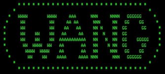

So I got the terminal and have been messing around with it a bit.
It has a video in bnc port and a centronics keyboard out.
I ordered a rf modulator and some adapters to see if that would work but I had a vga to bnc cable laying around and decided to test it out.
It displays this scrolling downwards so i assumed it had something to do with hsync or vsync?

You know you have success when you get it to display this:
Some of the terminals display that whilst waiting for a network connection. Either way, once connection is achieved, that's what it will display.

The connectors on the back are for their office network. If you open it up, you should see a microprocessor, video controller, memory and their
office network interface. I just bought a knockoff terminal in a Qume case that has the same connectors. http://www.ebay.com/itm/222251438403
The company lost in a patent infrigment case with Wang and had to take it off the market. I'll have to see if I can find the relevant patent numbers.
The patent is 4145739 mentioned in
https://news.google.com/newspapers?...ZwrAAAAIBAJ&sjid=F_wFAAAAIBAJ&pg=4277,2343641
Pulled a copy down through patent2pdf, the exact terminal is show in the patent.
