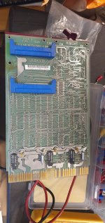

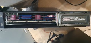

The 780 uses floppy disks to boot the console processor: 8" Floppies at DEC VAX, 5,25" disks originally at my VAX.
Would you like to publish a picture of the VAX interface card?
The usual boards in the 780's console processor are M7264-YC, M7946, M7940, M8400-EH, M9400-YE.
The last one is VAX interface.
My VAX has an 1/2" tape, but currently no tape controller.
OK so I don't have an M8400-EH but an M8044-EE. The M9400-YE is pretty bare. No ROMs (sorry). I wonder how this booted because the hardware guide suggests it has ROMS . I wonder if they were in the 11/780?

No need. You found the buyer. The first cabinet arrived today (waiting on the disks). I'm not an expert on this system, but so far it looks like I'm missing the console 11/03 and all of the bootstrap / microcode floppies (hoping to get a copy/image from someone). If there is something you want me to look at on my system, happy to help. It is otherwise complete.
Thanks! The PDP 11/03 would normally sit in the lower left-hand corner of the 11/780 cabinet. Above the 11/03 you would have a memory battery backup (also missing in my unit). The 11/03 would be paired with a single RX01 drive on a swing-out tray. The 11/03 has a M9400-YE which is a QBus terminator + ribbon cable adapter (simple board). That would have two 40-pin ribbon cables running up to J7 and J8 on the 11/780 CPU backplane. My unit is also missing the ribbon cables, but those are easy enough to make new. J7 and J8 are wired to the console interface board (last slot on the CPU backplane) that just runs QBus back to the 11/03 and exposes registers that the 11/03 manipulates the microcode. That is the limit of my knowledge on this part of the system, I suppose I will learn more as I make progress on this restoration!
