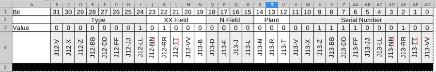

Ok, it looks like there is very limited information online. I'm hoping someone has these files otherwise it seems this machine is a paperweight. Looking at J12 and J13 on the CPU backplane, I come up with:
Which maps out to:
Type: 01 (decodes to 11780)
Revision: 8
Letter: None (decodes to 0)
Plant code: NI
Serial: 964
It's clear looking at the jumpers that this system has had a few ECOs applied in the field. I confirmed I have M8238 (which is the newer WCS module introduced in 7.0) instead of M8233. According to the copy of K-RM-1178X online, I can use either WCS125 or WCS126.
11780-8.0 REVISION SUMMARY

So far I've only found copies of WCS120 and WCS123 online. Do you know anyone that would have access to these files?

I was aware of this but wasn't aware of how critical it is to be matched down to the component level. Buyer beware I guess (if you're shopping for this stuff on eBay). I got lucky that I got a mostly complete system without having to piece things together.
I did a full inventory of all cards and options, and for the most part things look ok. There are a few discrepancies, however.
From J12 + J13, the system is coded for version 8.0; based on that I should have:
OptionExpected VersionActual Version
KA7807.07.0
FP7802.02.0
DW78001,1A,1B,C1,D11B
MS780-E/H00B
RH780 #104,AA1,AB1,B1,C14.0
RH780 #204,AA1,AB1,B1,C1B1
The only module level discrepency is the memory which is a rev B instead of a 00. This may be as simple as changing the jumpers on J12/J13 to re-ID the system (there don't appear to be any other difference between the 8.0 and 8.B) system version. All of the option modules (FP780, DW780, MS780, both RH780s) have cards which are consistent with the module versions.
Within the KA780 I have 3 card discrepancies. Some of the cards have a yellow tag on them, I assume that means these were likely field modified ECO'd
  • M8236 should be C or D
    • mine has no revision marking
    • this card has a yellow tag / band on it
  • M8238 should be rev A
    • mine is rev B
    • I suspect this is a non-issue and likely that rev was released after this document
  • M8221 should be rev A or B
Given the fact that the rest of the system is very consistent, I suspect these discrepancies are probably minor and the system ran fine prior to decomm
