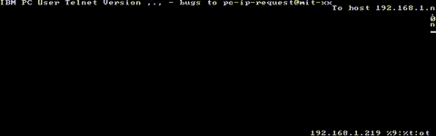

I know this is going to sound crazy, but is there any other files besides the ones on bitsavers for MIT PC/IP? They don't include clean copies of the libc which they only have fragmented reverse patches for.. It's quite weird.
I've managed to cobble together a build system using 4.1BSD's ar/ranlib GNU's cpp/ld along with some of the other utilities to build the ping & telnet client, although the formatting is all wrong with more cr/lf issues for some reason. I think I need to re-base libc on the non 8087 one, along with the MIT PC/IP stack? I donno.
I've been able to connect to a test BBS at home just fine so at least I've been able to rebuild it all from source, which I guess counts for something.

No real idea. Some years ago I was looking around for the MIT PC/IP and all I could find on the Internet was the later CMU-improved version. I didn't do anything with it, just wanted to look at it, having looked at what it had turned into at TWG (it had been turned into a TSR that could handle multiple applications using it for network access and had a sockets-flavor API bolted on top, then had a bunch of stuff (including some basic TCP functionality) ripped out of the TSR to reduce its memory footprint.
I think that when I got to TWG (late 1989) the toolchain for the TCP/IP TSR was Microsoft C 5.1. I found a Manx Aztec C for MS-DOS box in the library so maybe that was used or evaluated, and have heard a story that the original WIN/PC 1.0 development was hosted on a VAX (not sure if VMS, Unix, or Eunice on VMS).
Remember that Unix C compilers (and their underpinnings for *printf()) will generate LF only for "\n", MS-DOS C compilers (and C code written for them) are more likely to generate CR LF. Something like that may explain some of the formatting I see in your GIF.
I managed to get it sorted out!
I'd written the full thing about it here:
With my github repo of all the ported tools and stuff here:
basically, I wasn't sure of which or how to merge some libc updates or what was going on since it seems I wasn't sure where or if there was any documentation on the source.
With the updates I had more things just build and they look a lot more correct. Although it really hates interfacing with SLIRP, so I suspect it has old style classful routing & masks at heart. It's been ages since I've seen a 192.168.0.0 "0 bit mask" referred to as "377,377,377,0"
I'd seen some mention of a later one ported to Microsoft C, I suspect it might be the CMU version. I'll have to go digging around for it.
It's been a somewhat confusing but fun adventure, that is for sure! I guess for anyone else from the future want to see, I've attached a DOS 2.11 boot disk with enough compiled and setup for my home network. Good thing DOS 2.11 also went MIT licensed ;)
