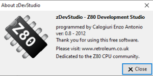

This may be a more general question, but it stems from the serial hex download program I am writing. As I've mentioned, the program starts at 0100h like all CP/M programs, but relocates the functional part up to address DB00h to execute the serial hex download part. My source code has two org statements; one for the relocation code at 0100h and the other for the serial hex download part at DB00h. When I assemble it, the resultant .COM file is 55K in size. I was a bit perplexed at this and discovered it is full of zeros from 0110h to DAFFh. I'm thinking that the relocation code would be moving zeros from 0110h to DB00h, which obviously would not work. So, any ideas how you would go about getting rid of all the space full of zeros? I sure did not expect that, and I'm sure there is some directive I have overlooked.

If you're using the simple CP/M-80 assembler, you'll have to code the absolute addresses as expressions with a stated relocation factor.
Some assemblers have distinct origin and location counters--the origin counter for where the code is assembled and the location counter for where it will be executed, so the adjustment is done for you. In particular, if you're using Microsoft M80, see page 3-15 in the manual. Plain old ASM doesn't have this feature. I'll check RMAC later if you wish.
I'm using zDevStudio. I love it. I guess what I could do Is assemble them as separate programs and then join them as one. More steps, but it would work.

Well, I figured out a workable way to do this.... Assemble the relocation portion of the code and the actual program, separately from each other, using their respective ORG addresses. Then a simple concatenation using a simple DOS copy command to join the two and it seems to not pad anything. So, I'm hoping that should do the trick.
