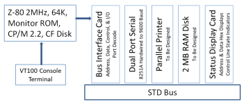

In my previous episode, I added some code to let me know where I was in executing my program. It seemed to be hung in the loop to read the status from the 8251A on port A. So I checked to see if there was an error in entering the code and I couldn't find one. So I went back to the code I used as a starting point. One uses a 'BIT' test and the other uses an 'AND" test. I tried both ways and got the same result. I'm thinking that either my hardware data path control logic is not functioning, or I have an issue with my coding. I guess both 8251A chips could be bad; but I highly doubt that. And I'm thinking it isn't a code issue, since the code works in other programs. Anyway, these first two are the examples of what I used, and the third is what is in my code..... And Merry Christmas and Happy Holidays

I'm trying to 'bootstrap' the machine. It has a monitor ROM which has an RS-232 port and also gets me into CP/M 2.2 from a CF card. I want to use the console port solely for connecting the a VT100 emulated terminal. The other two 8251A RS-232 ports are for other peripherals. I want the ability to use one of them to download code from my PC. That is the sole reason for building the dual port serial card. I've in the process of debugging the hardware/software to figure out what isn't working. I'm probably going to have to wire up some kind of status indicators to do that since I do not have access to a logic analyzer.
darn, big typo... I'm NOT trying to bootstrap..... makes all the difference in the world.... sorry for the confusion.

That being said, I still think the 8251 is a terrible device. At the time it was introduced, the unique thing was that it could do both sync and async protocols. But it was a beast to get to work reliably.
Even in 2020 folks were still having issues with it
I last opined on it 6 years ago, and I haven't changed my opinion at all since then
Just as an aside, I trust that you're running the serial clock at 16X...don't try to do 1X; it doesn't work with async.
Yep, 1.836 MHz divided by 12 to get to 153KHz. The Mode instruction is 4Eh which is 16X, 8 data bits, no parity, and 1 stop bit.
