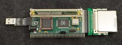

I converted the prototype SIMM30 tester I built a month ago into a Z80 SBC for RC2014. It is a revised ZRC where onboard 2meg DRAM is replaced with a dual SIMM-30 socket. It is a 4-layer 50mmX100mm pc board; Z80 is running 14.7MHz and it is RomWBW ready. I purchased a pair of 16meg SIMM30 for this board, but memory is currently limited to 8 megabyte because the byte-wide bank register can only hold 256 banks of 32KB bank. To go to 32MB, I need 10-bit bank register that writes 10 bits bank values in one I/O operation.
Thinking about an application that will use 8meg of RAM...
DANG! It never occurred to me to purchase a rail of PLCC Z80 chips. Can this board function with the CPU removed and installed on a different card?
The board should work with external Z80, but needs 2 modifications. This is because the classic 40-pin RC2014 bus does not bring out WAIT and REFRESH, so these two signals need to connect to the spare signal pins of RC2014. I’ll try that tonight.
I’ve started a homepage for ZRC rev2. I’ll add schematics, gerber artwork, and CPLD design files in a day or two.
the 80 pin interface appears to have these signals, https://smallcomputercentral.com/wp-content/uploads/2023/03/rcbus-specification-v1.0-2023-03-17.pdf
