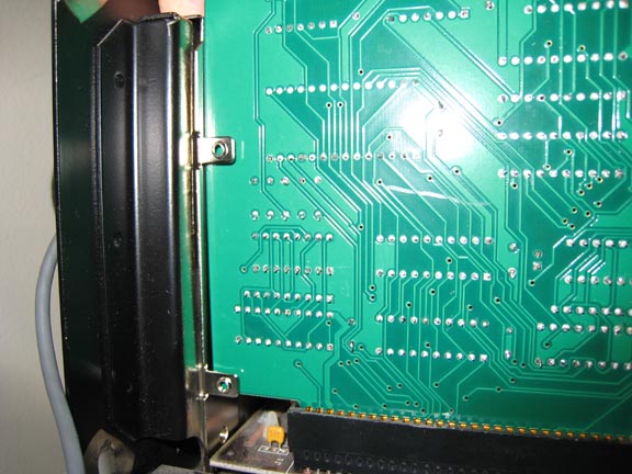

Hi Hargle! OK, I added the write enable jumper to the design.
Worked a bit on the bracket and discovered that bracket is not going to work. I installed my board in the test station and also the bracket. I used a pin to scratch through where the screws would go. Try installing it yourself and see if you can duplicate my results.
It turns out the bracket's holes need to be deeper and higher on the board. This bracket places its lowest hole almost directly in the lower right hand corner of the board. The holes would be centered 5/32" left of right hand edge and the lower hole would only be centered 1/8" above the bottom edge and the higher hole 2 3/8" . The bracket appears to need a 1/8" diameter hole so you can see that leaves almost no margin (~1/16") of PCB material for strength. The bracket would surely break off in normal use.
I'll search around at Mouser to see if they have a different part we can use. However, the more I think about it, I like the idea that Richard brought up about using one of those single hole plastic brackets.
Thanks and have a nice day!
Andrew Lynch
yep. I see exactly what you mean:
I assume an extra route of PCB to dangle down lower than the connector would cost extra bucks due to the additional cutting the PCB folks would need to do?
What a bummer.
Let's go find those plastic bits. that's our only hope.
The acculogic card has one. It's got a part number that says "63-000332-B" patent number 4745524
http://www.google.com/patents?vid=USPAT4745524
I don't have time to search much, but maybe that'll give us some leads. If we can find them, they're probably cheaper than the $1.89 per metal bracket from mouser!
What a bummer.
Hi! Yes, I can adjust the outline of the PCB by adding 25 mils to the righthand side and making a little bump out for the lower hole. However, you are right that any adjustments to the PCB outline will increase area and drive costs up. Maybe not by much but some. Also any bump out on the PCB outline protruding down runs the risk of interference with motherboard parts. I don't see it as much of risk but some.
After reviewing this patent there is no doubt in my mind that this is the way to go assuming we can find these plastic or metal clips. They would be ideal for this application. Leave the blank ISA filler bracket in place and drop the board in on top. That is very slick and a great idea. Depending on what we find it may not require any holes at all or maybe just one. I will dig through my ISA boards and see if I can find any part numbers. A quick search didn't reveal any though.

Why not leave the card without mounting holes - then the user provide their own bracket and can drill holes in suitable places.
I've got loads of old/broken cards I can rob the brackets from. Just a thought :)
Yep, I agree with this too. Just push all the traces over 1/2" or so and just leave that edge of the card blank. Users can provide their own bracket and drill their own holes if needed. Especially if we can't find the little tab thingies.
Hi! I think this is the best idea yet by far. Reuse scrap brackets and let the builders use their own (or not). Making a 1/2" trace exclusion zone on the PCB will give the autorouter fits but I can live with that. This is a very appealing solution to me.

Hi! Another thought on brackets... I could just place a couple of holes on the PCB and we could use a couple of these so builders could make their own bracket fairly easily. Just drill a couple holes into a blank bracket and fasten to the card with two 4/40 machine screws.
Blank brackets are really inexpensive and the right angle mounting brackets are pretty cheap too.

Would be cool if we could make a hardcard out of one (basically mount a HD on the end with some metal brackets). yea, I know thats not going to happen.
There's nothing stopping you from mounting an IDE->CF adapter on it though.
Totally lightweight and could be ziptied on to the card with little or no effort.
