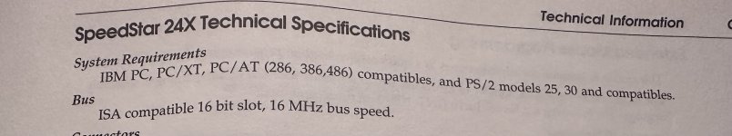

Diamond Speedstar 24X is compatible with XT machines according to the manual:
chjmartin2
Dec 26, 2012
361
I am talking to myself now, but I got one of these off of e-bay and tried it in two XT's and no video, no nada. So, either the board is DOA or it says it works but it doesn't. I don't have a ready 286/386/486 to try the card in. Will continue the journey though because now I need to know if it actually works.
chjmartin2
Dec 26, 2012
361

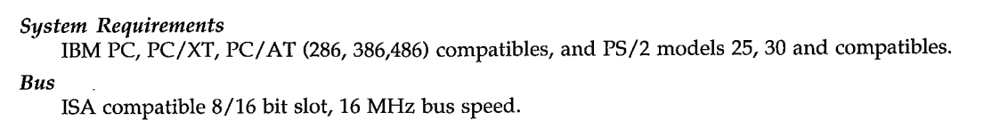

Ok.... very odd.... here are the tech specs for the SpeedSTAR 24X. The above is the SpeedSTAR not the SpeedSTAR 24X. Here is the 24X:
Not sure how it can be compatible with a PC/XT but then require a 16 bit slot and 16 MHz bus. Even more odd is that there is a jumper for 8 bit and 16 bit bios. Regardless I got a second Speedstar 24X and this one doesn't work either - so seems like the manual is incorrect about compatibility or at least in conflict with itself.

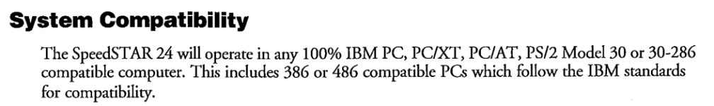

Referring back to the Speedstar 24, it says this:
How can an 8 bit slot run at 16 MHz bus speed?????

Some later chipsets let you run the ISA bus at CPU speed /2, /3, /4. I suspect with the right combination of adjustments you could get, say, a 33MHz CPU and 16MHz bus.
You could also use an XT-style design with coupled bus clock and a 16MHz CPU. I've tried that with a 20MHz V40-- even if you throw loads of wait states at the problem, a lot of stuff just gives up after 14 or 16MHz.

Until you test the board in another computer, you'll never know.
The Diamond Speedstar 24X is, in fact, a good board that works in a tested 386. I also found and purchased a Diamond Speedstar 24, which as you see above shows XT compatibility. I am happy to report that this card works well in my Vendex 888-XT. It is the fastest card, so far, that I have used in the machine. I can get the 32k color mode in 640x480 and 800x600 to work using the TSENG 4000 vesa 1.2 drivers. I have not had success with the 16.7M color mode. Additionally, I tried using the Windows 3.1 Hicolor drivers in Windows 3.0 but that didn't work. It is very satisfying to see 32k colors come out of my Vendex. Thought I would share as it appears to be a nice card to use with an 8 bit slot.
