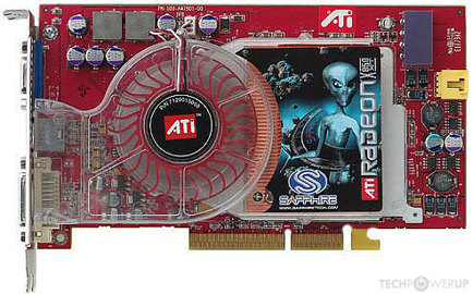

All this agp talk now has me wondering. What was the fastest AGP card that was actually AGP and not PCIe with an AGP bridge?
It's hard to know because in the dying days of AGP, both Nvidia and ATI released sub models of their GPU ASICs with official AGP support, and they also made bridge chips that went in both directions. PCIe adapted GPUs were released long after AGP motherboards stopped being offered. AGP was pretty much dead and gone by 2006, but the HD4650/70 had AGP variants released in September of 2008. Nvidia had the 7950GT in April of 2007, but that wasn't officially supported, it was only offered by a few board vendors using bridge chips.
I'm going to say that the Geforce 6800 Ultra (NV40) is probably the last official AGP GPU from Nvidia, and the Radeon x850 XT (R360) for ATI.
The easiest way to tell whether a card is a true AGP card or not is the presence of a bridge chip. If it has one, it's just a PCIe GPU smurfing as an AGP GPU.
