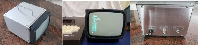

I forgot to mention, I also have one of those open frame 5.5" NOS Panasonic VDU's, which has had some cladding added (attractive satin anodized aluminium) and has a chrome handle. It is powered simply by a 12V 1A capable wall wart or similar. The screen picture doesn't do it justice, the screen Text & focus is as sharp as a tack being fed by the RM-65 video board.
If nostalgia got the better of you I could sell it for $250 plus shipping, I think it would be around $50 for Air post shipping to the USA.
Another NOS item I have is the printer units for the AIM-65 , these were made by Shimadzu in Japan, they are a true masterpiece of electro-mechanical engineering and Japanese perfectionism. I had to search the Globe to find them, they are very rare NOS. They cost a small fortune to buy and to bring to Australia, I only have a very small number. Even the parts for these like rubber rollers can sell for outrageous prices, I put one on ebay as an experiment, but of course I'm always open to offers.
