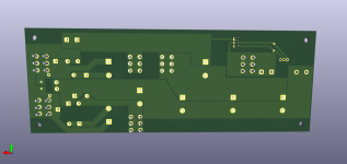

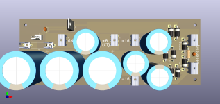

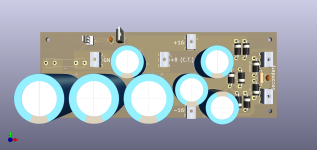

Alright here is the final draft of the power board. Due to the height of the capacitors, it will not clear the full width fan on the original altair, but a modern 12VDC 120mm fan will easily fit in it's place due to its reduced thickness.

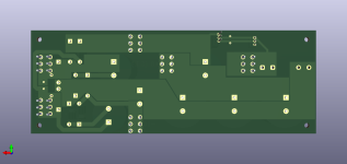

Ok one final revision. Moves the 16V and fan connectors slightly forward to get more fan clearance. Also got a little more current capacity on the negative rail just in case.s100 power.pngs100 power back.png
I sent the board to fab. Made a couple revisions since I posted last, most notably adding M4 mounting hole to allow it to be mounted to the existing screw bosses in the altair clone cabinet using 12mm standoffs. Here's the setup mocked up in my clone cab20250129_125148.jpg
The power board works great! I'll try to get the kicad files and a BOM up to github tomorrow. The only very minor issue is that the leads on those SBX2540-3G schottkies are ever so slightly thicker than a standard DO-201 package. They still fit in the through holes with minor persuasion.
I'm getting unloaded voltages of 9.5V and +/- 18.5V. Fan is getting a solid 11.8V from the 7812 while operating.

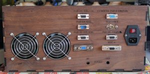

I have one of the original Mike Douglas cabinets (he passed the files over to Chris to continue having them made to sell), but now I'm building my own cabinets from Oakwood.
I like the "homemade" look rather than the copy look ... the best thing is these cabinets cost about $30 to build.
