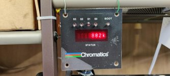

I wish I could help out, but I did have a Chromatics VME system years ago and the monitor was a beast. I still have a few parts, but most was scrapped or used for other purposes.
Attached is a photo of the front console that I still use to monitor traffic in and out of my router. I was able to interface the panel to a Teensy microcontroller.
