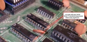

Actually those TI IC's are interesting.
If you look closely at them, you will see that their ends have saw marks where a type of grinding disc cutter was used to separate the IC's at the factory.
Also, if you check the resin body that the IC is made from, and try to melt it with the tip of your soldering iron, you will find that it has a much higher melting point than the resin case of a modern IC, and it is much more brittle.
These original TI logic IC's were very solid. Though, unfortunately TI used steel pins (if you check they are magnetic) and they Silver plated them. Good when new but as the years pass the silver plating fails and the steel rusts.
These IC's may well be ok, but it is good to clean off the rust with 1000 or 2000 grade paper and then a subtle brush with Fertan to deactivate the remaining rust and then apply a surface oil like Inox MX-3.
You may be able to save these unique early TI IC's.
