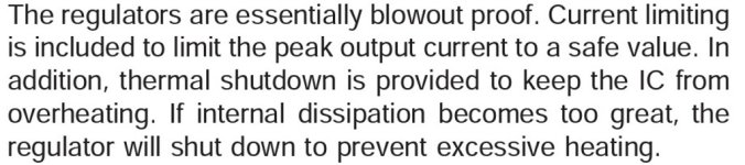

I have attached a photo of National's original part on a home made power supply. I have also attached a remark from National's data sheet. Perhaps tempting fate saying they are "blowout proof", but on the whole I would have to agree they are.

If you read up on these regulators from their data sheets, you would learn that they incorporate protective systems. If their output is overloaded, they will shut down. It does not mean that the regulator is "broken". So you need to determine if they are overloaded or not. Can you think of a way to do that ?
As I have have stated back in post #16 (and Hugo has also stated) the regulator may not be dead just because the output voltage is very low. It might have gone into shutdown mode because of either a high temperature or a high current flow. Once the voltage regulator has shutdown, you need to power it OFF to reset it.
