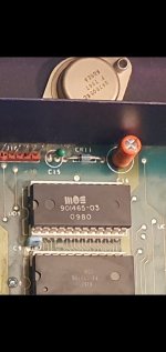

have been looking at the motherboard under a microscope for a couple of hours now and tested diffrent components for shorts. I found one short on C15 it,s a smal green cap. I think it is a 1000nf cap. Atleast my tester say so. I have not been able to verify this agains the schematic becouse I dont think the schematic on Zimmer match my motherboard.
Anyway I changed the cap to a 1uf regular and the short is gone. But I still have that low voltage on cr11.

C15 is a 1 uF tantalum bead capacitor (aka smurf grenade). This is on the input to voltage regulator VR4. This voltage measured ok.
These devices are polarised. Putting them in the wrong way round is not advisable...
Im starting to suspect that the 7805 voltage regulator is bad after all.
C15 (a Tant cap) filters the INPUT to the regulator, not the regulator's output. C15 is also in parallel with C17, on the input to the other 5V regulator that is now working, so it is not plausible that C15 could be your problem is it ?

When you are looking for shorts, don't use the diode & beep function on the DVM, use it on Ohms range and document the resistance. In this case, as you have just found out, you were led to believe there was a short across C15, when there definitely was not one. That is evident from the schematic.
Also, rather than hunting around on the pcb with tests that could lead you up a garden path, like finding a capacitor that looks shorted, you need to keep consulting the schematic, and targeting the test areas on the pcb. For example you are interested in the circuitry that the output of the specific 7805 regulator feeds, with the low 240mV output, not this regulator's input circuit which is common to both 7805 regulators. You should know that input circuit to the 7805 regulators must be ok, or the other 7805 would not be working properly would it ?
In addition, if logic prevails, your tester would not have been able to measure the capacitance of 1uF on that green tantalum capacitor, if it was indeed shorted out.

@daver2 Im getting a little confused. At the 2001N parts list C15 is a 10uf 25v tant cap. not a 1uf. Are u 100% sure this is the right schematic for Pet 3032?

The schematic lists C15 as 1.0 uF...
All you can do is to compare what you have with what is on Zimmers and hope! That is the best we have! Sometimes boards were also replaced, so differ from the labels on the front if the PET...
