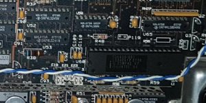

So, I got this Compaq Portable III (386DX20), which was basically in pieces, because the previous owner tried to fix a crumbled keyboard cable. I think he forgot to write down the wire colors on the DIN5 connector before trying to replace the cable, because when I got it, each of the 4 wires was soldered to a metal pin. So I think he got tired and started to stick the pins in different combinations into the DIN5 port on the Portable III. It seems that while doing that, he blew something on the system board. I already replaced the keyboard controller chip (Intel 106436-001) on the board, as it got quite hot to the touch, but I'm still getting a 301/304 Keyboard Error in Post.

I already replaced the keyboard controller chip (Intel 106436-001) on the board, ...
Not an Intel part number; a Compaq one. The "106436-001" is an Intel D8742 (multipurpose microcontroller) chip that Compaq have programmed with software that turns it into a 'keyboard controller' suitable for the Compaq motherboards where it gets fitted. Compaq have then assigned its part number of 106436-001 to that particular combination of hardware and software.
Hopefully, the "106436-001" that you acquired is programmed.
In the IBM AT, IBM have also used a programmed 8742 (or 8042). For whatever it is worth, the keyboard interface of the IBM AT's motherboard is shown at [here]. Compaq may have done something very similar. Note the chips between the controller and keyboard connector.
That's actually some pretty good insight, thank you. I didn't know that the 106436-001 is actually a D8742, the original controller wasn't marked like the one in your picture. I found some NOS 106436-001 from a seller in Poland, they were actually dirt cheap, too.
I was hoping that there was something between the controller and the connector to go on, but without the schematics I was a bit lost on this board, as the chip density is pretty high. I think the next step is to trace the DATA and CLOCK lines from the connector to pins 37 and 38 on the controller, something in between there must be screwed.

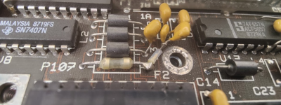

One last post in this thread as I just found the problem with my system. It was a blown fuse "F2". Replacing this makes the keyboard work again. See image.

@Jurnd this worked for me too!!! thanx man, I had this issue for too long! This is a 5A fuse for anyone not able to recognize.
my error code was: 301 keyboard error during post.

@Jurnd This also save me from my despair. I didn't realise the O-B-V-I-O-U-S fuse and was looking everywhere. Really appreciate it !!!
