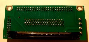

New SCSI hard drive arrived in the mail; it is 80-pin SCA SCSI. So after that, I had to wait for a SCSI 80-68-50-pin adaptor. That adaptor arrived today.
Questions:
  • The Molex connector on the adaptor is to provide power to the 80-pin set, because the 80-pin hard drive has no Molex connector, correct?
  • The jumper pins on the adaptor are labeled LED, SYN (synchronous), DLY (delay device starting, as discussed earlier), MTR ("RMT-Start" says the leaflet that came with it), and the SCSI ID binary digit pins.
    • What is the LED this is talking about? I don't see one on the adaptor.
    • What is "synchronous"?
    • What is "RMT-Start"?
I plug the new HDD into the adaptor. I plug a Molex connector into the adaptor. I plug the 68-pin SCSI cable into the adaptor. In scanning for devices in the SCSI BIOS, the card is not seeing either the new hard drive or the CD-ROM drive. It has seen the CD-ROM drive before.

SCA = "Single Connector Attachment". Just that--it carries power and signal lines in a single connector. So yes, the 4-pin Molex is a standard 12-0-0-5 disk power connection.
Let's look at the jumper block. There should be no jumper on that position--it's for attaching a LED activity indicator. SYN shouldn't matter as the Adaptec controller doesn't care about spindle synchronization. Similarly, leave DLY unjumpered.
D0-D3 should all un-jumpered for SCSI ID 0, or D0 jumpered for SCSI ID 1.
See:here for details.
Does the drive spin up with no cables (other than power) connected?
If the HDD's 68-pin SCSI ribbon is connected to J1 on the Adaptec SCSI card, the HDD built-in LED comes on and stays on. The drive does not spin up.
If the HHD's 68-pin SCSI ribbon is connected to J2 on the Adaptec SCSI card, the HDD spins up and its LED comes on. The LED then goes off and the drive remains spinning.

Let's try to go about this thing methodically (I did warn against SCA-connected drives :)--the adapter is just one more thing to go wrong). There should be no difference in drive behavior (spin-up) between the internal or external connectors. Many SCSI drives will refuse to spin up if the connector is on upside-down. We'll assume that the drive is operational for now, which leaves us with the cable and adapter. Double-check the cable, please.

I assume that the SCSI BIOS scan at bootup doesn't report anything with the drive on either connector. This is not good. Have you buzzed the 68-conductor cable out end-to-end?
Correct.
If by buzz you mean continuity check, no. I'll do that now.
I checked continuity between the two connectors that connect to the card and the drive. All wires are good.
I tried a 50-pin SCSI HDD. It was not recognized. The CD-ROM drive was also not recognized, which happens more often than not.
I tried the same Adaptec card with the 80-pin SCA HDD in a different computer. Same result. I didn't connect the CD-ROM drive to it that time.
Maybe the card. That seems the most likely cause at this point, other than being 0 for 2 on SCSI HDDs. I don't have another SCSI card like this to swap. If/when I get another SCSI HDD I will keep trying.
