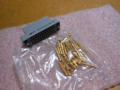

Is anyone aware of a source for the Winchester MRAC connectors used for the disk bus and power connections on the Diablo series 30 disk drives? Alternatively, has anyone built something compatible using pogo pins or an array of contacts mounted to a circuit board that could connect to the drive?

attached is all of the info on male mrac42 plugs. they are expensive and the solder tail 8142 pins are hard to find and around 2$ PER PIN
In addition to the adapter PCB, I/m looking into using one of the following types of pins to make the "P" side of the connector:
Have some in the Digikey cart to try them out to see how well they fit in the Diablo "S" side of the connector.
Pins on the Diablo MRAC42P are 0.062" diameter.
To make the "P" side of the connector, do something like this:
1. plug 42 pins into an actual MRAC42S, such as the socket on a Diablo Terminator​
2. fit the adapter PCB over the solder tail side of the pins​
3. solder all 42 pins​
4. unplug the soldered adapter from the MRAC42S​
It might be necessary to fit a thin plastic 3D printed piece with 42 holes over the base of the pins after soldering, not sure about that yet.
The mounting screws are a harder problem. A thumb screw, aka shoulder screw could attach one side. The part with the nut in the shaft I don't know yet. Maybe something like a shoulder screw permanently fixed to a round metal threaded standoff.
However, the first step is to just make a Diablo adapter using a real MRAC42P and confirm that it works.

also MRAC is the 'compact' version of the MRA connector. MIL spec for the pins MIL-DTL-28748C
AMP makes a rolled-pin tin version of the pin 66471-3

Making a plastic block drilled out for the AMP rolled-pin .062 pins is probably going to be the least expensive way to make those cards.
In that case, plug pins make the connector block thinner because the socket pins are recessed into the connector block.
All you'd have to do for the plug block is drill a smaller diameter hole for the solder-side pins and counter-sink for the plug end
and do the same for the block to pcb attachment screws.
Soldering the pins to the PCB holds the pins in place. The AMP pins are only .7" long while the MRAC is 1.3"
You want to make the plastic blocks out of something that doesn't melt at soldering temperatures.
The AMP pins look like they are just their crimp pins with a solder pin crimped on
I went down the DIY rathole this morning because plug plastic blocks seem to be less available and more expensive than sockets.
Here is a plug block price https://www.mouser.com/ProductDetail/Amphenol-Positronic/GMCT42M0T0000-AA?qs=QpmGXVUTftG68fElJff6TQ==

In my opinion, with the prices the way they are for 'genuine' connector components, the only viable solution would be a reproduction. Gwiley seems like he has a good way forward for the 'P' contacts, but that still leaves the (last I checked) more difficult to acquire 'S' contacts.
S bodies (at least on eBay) are cheaper than P
you still have to source the solder pins at 1-2$ ea
https://www.ebay.com/itm/233868116699 is nice that it has the thumbscrews
