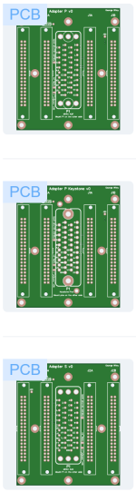

JLCPCB is currently building these (almost complete):
The top one, Adapter P, can be built with an MRAC42P mounted on the bottom side and 4 headers on the top side.
The second one, Adapter P Keystone, can be built with 42 Keystone 1362-2 Micro Pins mounted on the bottom side and 4 headers on the top side. This will be a fun experiment.
The third one, Adapter S, can be built with an MRAC42S mounted on the bottom side and 4 headers on the top side.
Adapter P Keystone gets all of its structure from the pins soldered to the PCB. A rather thin (0.192") plastic piece with 42 holes is planned to fit over the pins. That plastic piece is fastened to the PCB with two #2 sheet metal screws. The only purpose of this plastic piece is to prevent the pins from seating too deeply into the socket connector on the drive. A thumbscrew like this one, 12mm length, holds the adapter to the drive on one side. Haven't figured out the other side.
Micropins, headers, and two Meanwell LRS-150F-15 15 volt 150 watt power supplies (to power the Diablo model 31) are on the way from Digikey.
