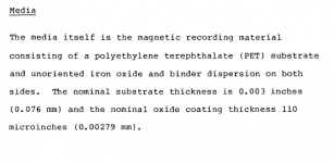

That isn't how magnetic tape or disks are made
You start with a mylar base and coat it with gamma ferric oxide in a plastic binder
The basic process is documented, both in books and patents.
