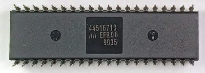

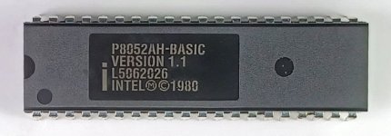

To follow up....I did receive the chip a week or so ago...this is it..
I do not know if this was made by Intel. It could have been and the 9035 could be a date code. I just don't know and I have searched around on the subject and found nothing determinant.
Not sure when I will get this project going and there may be information within the chip that will shed some light on the subject.

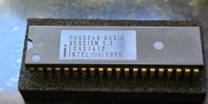

For what it's worth, here is a P8052AH-BASIC chip I purchased on eBay back in 2017 which also has a 9035 code on the bottom.
The printing on the top of the one I have looks slightly different than on the one you have. The character spacing looks closer to fixed width on the one I have and spread out slightly wider compared to the one you have. No idea if that really means anything.

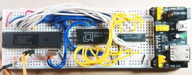

Got around to doing some more more on this 'project'
Bread boarded the simple 3 chip system straight from the MCS Basic-52 Operating and reference manual.
Connected up Tera Term and....
Then I substituted an AT89S52 which I had programmed with 8052 AH-Basic V1.3
Sweet!
I better go lie down on the couch for a while, all this stuff working is fatiguing :)
