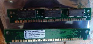

Wait, you only bought 2 SIMMs? The 486 having a 32bit data bus requires they be installed in matching sets of 4...... Ok lets get to the updates... Im not happy.
So the RAM came in: View attachment 1273412
No matter what combination I try it wont work. I learned that this machine wont boot with any less than four of the ram sockets populated with 1MB simms which need to be installed with the first simm closest to the CACHE chips.
So if those wont work what do I do? I cant return them. Thats money lost I guess. Any ideas?
