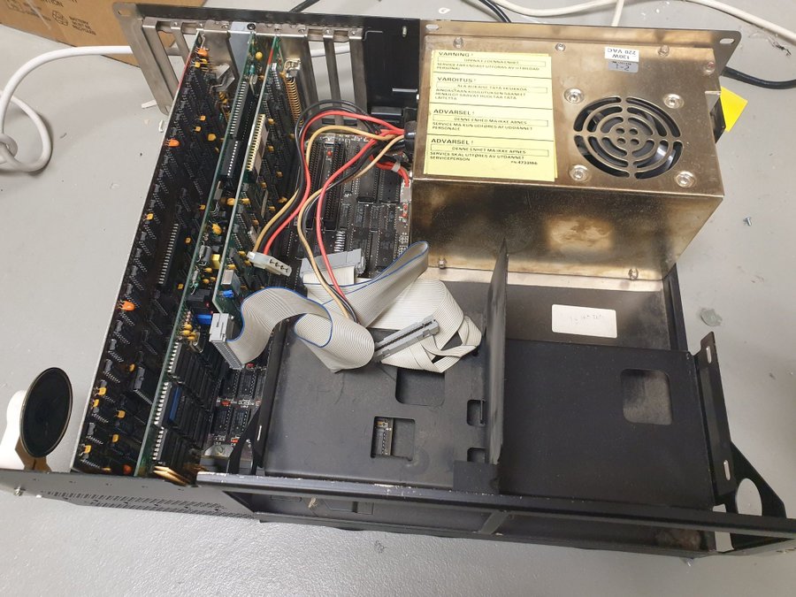

While waiting for my barebones 5160 XT system to arrive by mail (as described here), I've started planning which storage devices to use for it. I've looked through several threads here, as well as many pages on minuszerodegrees, but I would really appreciate if someone would take a look at this and tell me if I'm correct in my assumptions or not.

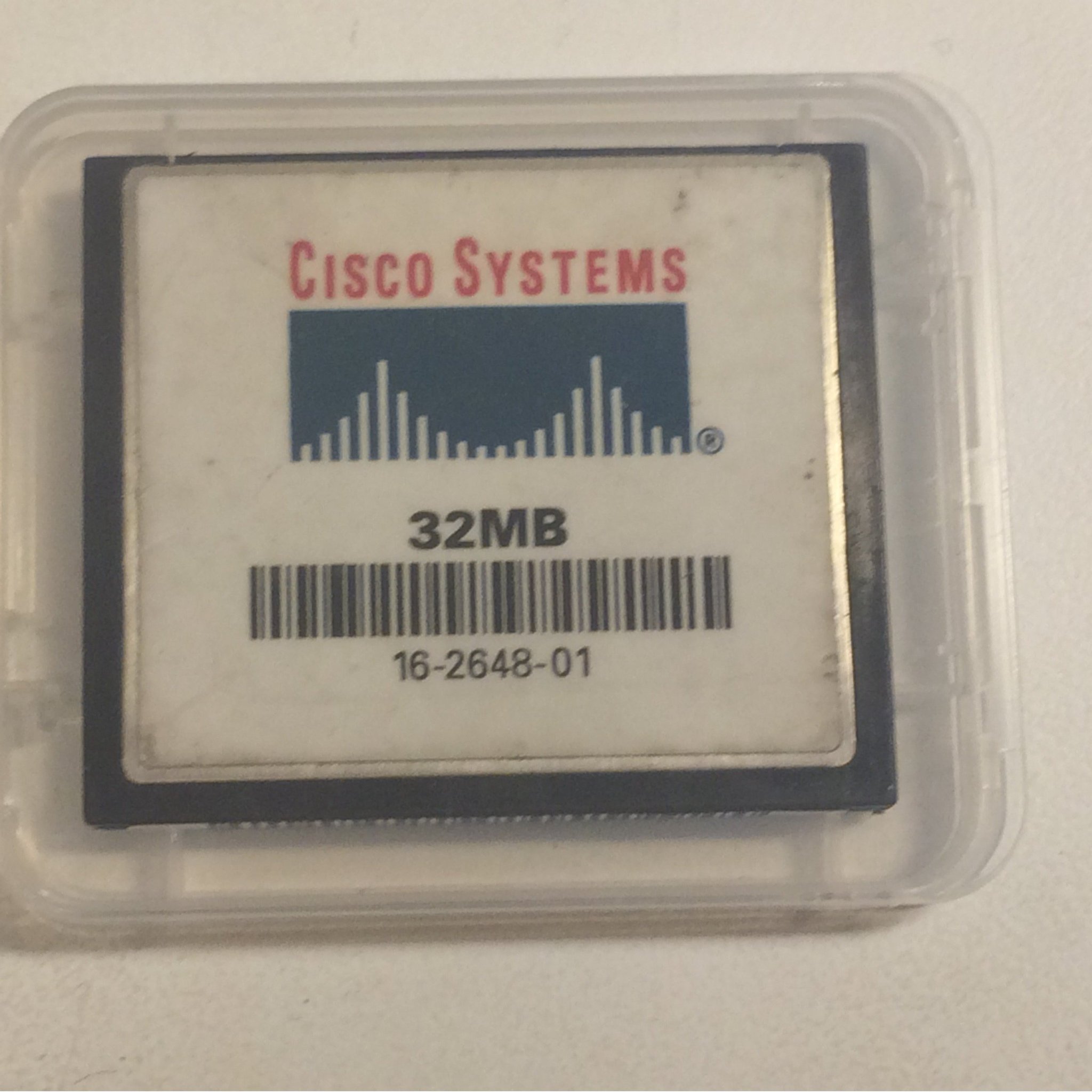

1. I've ordered this XTIDE card to use as harddrive and bought this compact flash card to use with it. I plan to install PC DOS 7.1/2000 on it.
2. I'm thinking about buying one 3.5" floppy drive and one full-height 5.25" 360 drive.
3. I know that the standard IBM floppy drive controller in the 5160 does not support 1.44 mb floppy disks, but that such a drive can be used as a 720 kb drive.
In the future, I will probably buy one of these in order to enable full 1.44 mb capacity, but that will be a month or so into the future (as I have already spent way more than what I should on old computer stuff this month).
QUESTION: When buying a cheap 1.44 mb 3.5" drive off Ebay, is there anything in particular that I should keep in mind? Are there internal 3.5" drives that won't vibe with an XT system? Would something like this work, for example?
4. To turn the 3.5" drive into half height, I'm planning on buying a cheap tray such as this and put the disk drive in it.
QUESTION 1
: Are there standardized measurements for such drives and mounting trays, so that I can just assume that it will fit nicely in the front panel of my XT, or are there certain considerations to make?
QUESTION 2: Besides the drive, the tray and some screws, is there anything else I need to mount the drive-in-tray in the front of my XT?
5. To make my XT setup more aesthetically pleasing, I've bought this half height face plate to put in the slot above or below the 3.5" drive.
QUESTION:
Is there anything more that I need to fit the face plate into the half height slot (screws or what not), or will it be snugly attached by itself, as it were?

Almost all 3.5" HD drives are "media sense". That is, the drive will operate in high-density mode if a high density disk is used, and correspondingly, will operate in low/double density if a double-density disk is used. However, a 5.25" drive does not use the same system and pin 2 comes into play. On most 3.5" drives, the pin is NC.
All drives in the PC world are set to the second drive select and cable with a twist is used. The drive after the twist is drive A:; the one before is drive B:.
Be aware that a 3.5" drive interfaces using a small 4-pin power connector and a 5.25" drive uses a larger "Molex" 4 pin connector. Similarly, the 5.25" drive uses a 34-conductor card-edge connector, whereas the 3.5" drive uses a standard 34-conductor "Berg" header. When the 3.5" to 5.25" mounting kits were in their heyday, adapters were sold for both the power cable and the signal cable.
If you want a good drive, stick with name brands. I've been a Teac adherent for longer than some here have been alive.
Also note that another possibility would be to use a "Combo" half-height drive, such as the Teac FD505, that includes both a 3.5" and a 5.25" drive in a single half-height 5.25" unit.
Would something like this be sufficient? for using a 3.5 floppy drive with my original 5160 FDC?
And would this work for supplying power to the 3.5 drive?
With both this question and the one right above taken in the context of using this particular FDD:
Yes, it's standardized. And you have 3.5 to 5.25 front adapter if you need that.
Nope that should be it.
Again that should be enough, the plate will have foldable plastic at the side that'll slide in and keep it tight.
Yup.

By the way, if I've understood it correctly, the XT CF LITE 4.1 isn't hooked up to the Hard drive controller. Thus, I can remove the HDC board entirely from the motherboard. Is that correct?

The the XT CF LITE 4.1 is the complete new harddrive system, so remove the old one.
