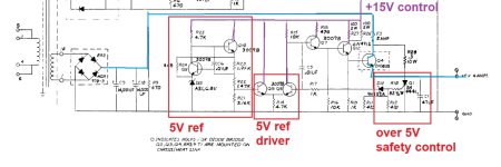

I have just acquired a DEC H758-a power supply.
The plus and minus 15VDC supplies seem to be fine but the +5VDC supply is not working (0.2VDC).
Does anyone have a schematic of this supply? I couldn't find it with a google search.

The +15 and -15 work but their power transistors get hot. The +5 does not work but I do see +10 output from the bridge rectifier.
Any suggestions?

Since all three pass transistors (Q2, Q3, Q4) are on the same heat sink you really can't tell which one is generating the heat. The +/- 15 outputs are OK, Q2 & Q3 are not generating heat. My guess is that Q4 is shorted or the Crowbar circuit has tripped, and is Q4 generating the heat.
Check the 5A fuse F3? Did someone replace it with a fuse bigger than 5A because it blew?
The SCR Q1 is a Crowbar that will short the +5V output to ground if it rises above a set limit, maybe about 6V. If the Crowbar trips it should blow fuse F3. If it does not blow fuse F3, the pass transistor Q4 will get turned on full trying to make 5V on the output. Q4 can handle more than 100W so it can generate heat like an big incandescent light bulb.
Q7-12 are all part of the voltage sense and drive circuitry for the pass transistor Q4. The Zener diode D13 is the voltage reference for the output, and Q9-Q11 are part of that circuit. Q8 compares the output voltage to the reference voltage, and controls Q7, Q12, and Q4 to regulate the output voltage. All of the reference and control circuitry is pulled up by the +15V supply, so it is good that that supply is working.
Measuring the Emitter, Base, and Collector voltages on Q4 would be helpful for debugging.

Thank you for your detailed circuit description. Once I clean the circuit board I will take some measurements and update this thread.

In essence you can see the blocks of that 5V regulator.
There is a 5V control circuit and becomes its power from the +15V rail.
Start with the 5V reference voltage constructed around zener D13.
Then you have the eventually +5V power circuit around Q7 and Q12 who both drive the Power transistor Q4.
There is a safety circuit. It measures the over voltage of +5V.
When in event of over voltage, +5,6V, the Thyristor Q1 is triggered and shorts the +5V output.
Normally that fuse F3 5A should blow.
To test the PSU, remove outputs from the computer.
Just now the PSU.
Remove R28 (0.3 Ohms 10W)
Remove fuse F3.
Check Q1 Thy for shortage
Check C9 and C10 for leakage
Check Q4
Start up PSU and start with 5V ref circuit
And see if there is voltage across R13
Zener D12 1N752A is a 5,6V zener diode.
Put in F3 and measure output.
See if output is high or low.
