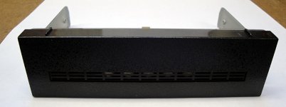

I got a 5170 recently with lots of documentation including that from an installed HDD upgrade. It mentions something called a "load resistor" which was placed in the casing of a 5170 without a HDD to create that minimum load, otherwise the system wouldn't function right. This resistor had to be removed when installing a HDD, which is why it was mentioned in the documentation.
I suspect that the same applies for older systems, load resistor or no, and that seems to be what you guys have come up with here.
Just sharing my two cents - a shame I didn't come across this thread sooner, as I might have saved some hassle, heh.
The load resistor you write of is mentioned (and there's a link to a picture) at the 5170 entry at our Wiki (VCWiki): http://wiki.vintage-computer.com/index.php/IBM_PC_AT_(5170)
I have a 5170 model 068 (no hard drive) in my house presently. I'm unsure why the load resistor is required, because the PSU fires up okay when I disconnect it.
The issue wasn't about whether a load was present or not - it was about the amount of load required.
That dummy load was a weird animal. Why the large metal cage? Maybe it acts as a heat sink.
The resistor is positioned in the cage middle, sitting on two thin metal legs (each with a cross section of about 1mm x 5mm). And so heat transfer from resistor to cage does not appear to be a major consideration.
The top plate looks to me to be a wonderful piece of over-engineering.
Hehe, that was a cool looking dummy HDD. It's of the kind that can fool a seller into thinking "This PC has a HDD but it does not work". It could also be used as a decoration on a newer PC to give it a bit of a vintage look :-)
