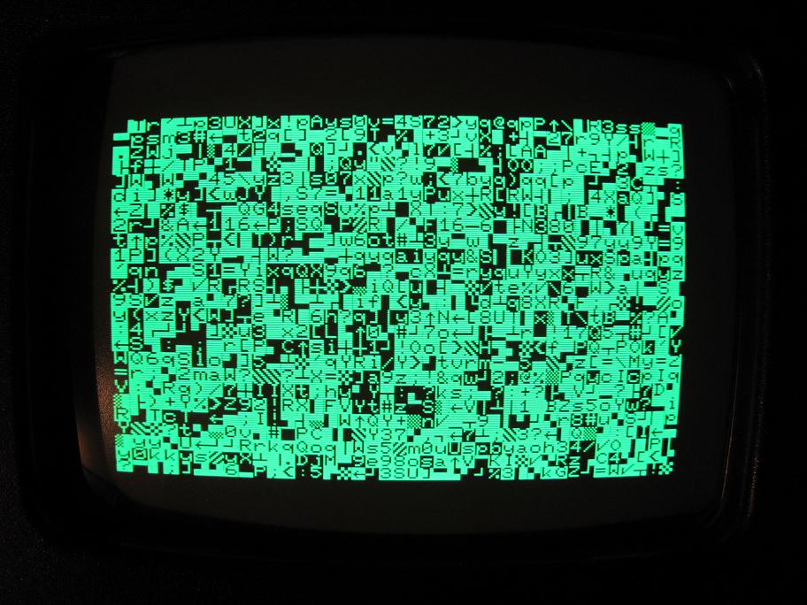

However, once started the display comes out with a really nice ( perfect condition ) picture of random garbage.
Actually "not really random" precisely is ALWAYS THE SAME "garbage" of mixed chars on screen.

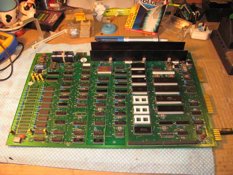

[edit] - a few pictures ( on the links ) added.

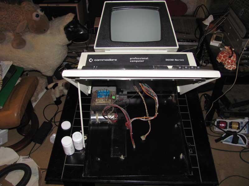

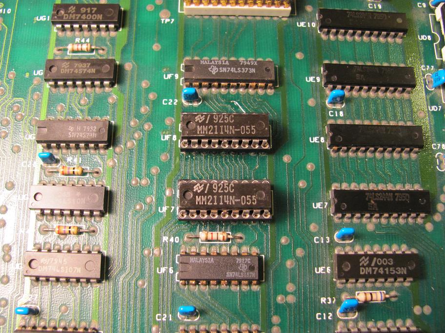

The machine as it arrived, it is in a really mint condition apart from the dust inside :
As it arrived, a bit dusty

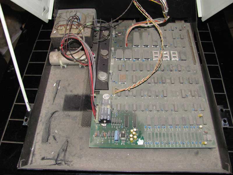

After patient cleaning with a thootbrush and a vacuum.
Cleaned board
Finally after replacing the fuse holder ( that was broken ) and a bit more cleaning.
More clean

2114 .. sdeng I have only TWO remaining "new", they are 2114 N-055 .. I think this means 55 ns access time but should be ok.
The only thing is, to make such a test it means to de-solder the original rams ( that could end up in destroying them ) and put some new socket and try the new rams in ..

I see, from the photos you added, that the big chips are all on sockets. That makes things a lot easier.
Originally there was 16K RAM reported so there is a bad memory chip(16K X1) in one of the eight upper 16K chips. The garbage characters on the screen means that the CPU is not running and/or the two video static RAM chips (2114) are not working.
Your model PET is the non CRT controller (6545) version which means the video timing will run properly even without a running CPU which is needed to initialize the 6545 video chip versions of the PET.

It took me a good 2 hours of sweat and prayers to arrive to this :
Yes I had a little problem with one track but I corrected it with some wire.
Checked all, etc. should be ok ..
However .. yes there is a change .. no it's not fixed yet .. what happens now
contrarely to before where we were always getting the SAME identical pattern now
the patter is random and sometime the 6th ? 7th char flickers with another one.
Every time you switch it on/off now the pattern is different around like this :
But is random now, it changes at every restart.

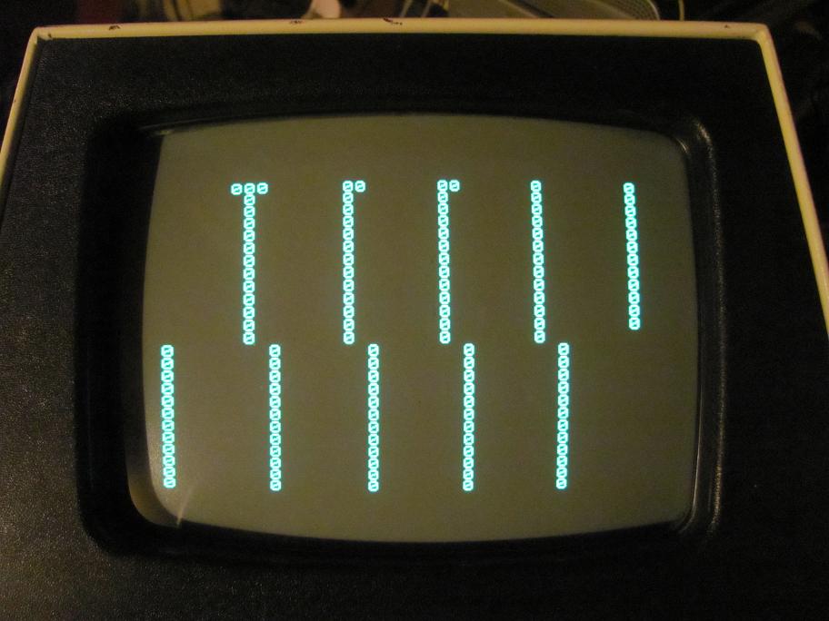

Updarte ..
I tried to remove first the two 6520 chips nothing was happening .. just the same ..
However after I removed the 6255 now the screen boots in random garbage but after about 1 second ( probably a bit less ) turns into this :
Am I getting somewhere ? Could it be the 6522 is busted ?
Eh .. if that is the case .. where could I find one as replacement ? ..
Pulling the 6522 VIA chip seems to allow the system to start up better. Normally on power up, the garbage is seen for a second and then is cleared and replaced with the Commodore message. So yes it looks to me like the 6522 is one of the things that may be bad. However note that the signal 'Graphic' is output from the VIA so that when was pulled, the open line sets the character generator into graphic mode and so who knows what the screen would look like.
Still no joy ..
We did try to replace the 6522 with one temporary took out from a Commodore 1541 drive that actually has 2 of them in.
.. nothing .. now we are again stuck in that 'random garbage screen' and looks like the CPU is not running at all ..

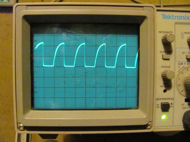

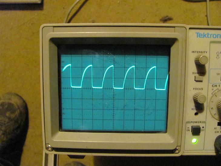

Maybe later on I'll try to check again with the oscilloscope and such, last time I was watching clock and all was ok, but the waveform coming out from "Phase2" was quite a bit odd, despite it should a NC pin I mean in the diagram looks like "Phase2" is not being used anywhere.
The clock was looking quite distorted, instead of being a nice square wave it was like there was a strong capacitor attached to it I don't say it was like a sawthoot but you know that kind of "banana shape pulse" ?
The 6502 output clock "phase2" (pin 39) is an important timing signal. Double check the schematic (which one are you using?). Also check to see that your scope probe has been "compensated" (there is a tweaker adjustment in the probe). Hook the probe to the 1KHz calibrate output on the scope, and tweak the probe screw adjust until you get a nice square wave. Then you can believe the signals you see on the scope.
The probe was still calibrated, however I re-calibrated it again 'at best', I am using it in X1 mode, DC.

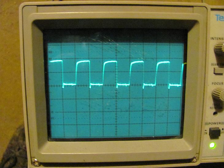

I made some captures, the settings are DC, 2V/div, 0.5Us/div.
I am actually getting a ground with a wire inserted into pin 12 of an empty ROM slot so there's a light path.
This is the clock that enters at PIN 37 :
This is the Phase 2 clock at PIN 39
Which I think it's quite strange .. ( I did check also that pin 21 and 1 are both ground, they are ).

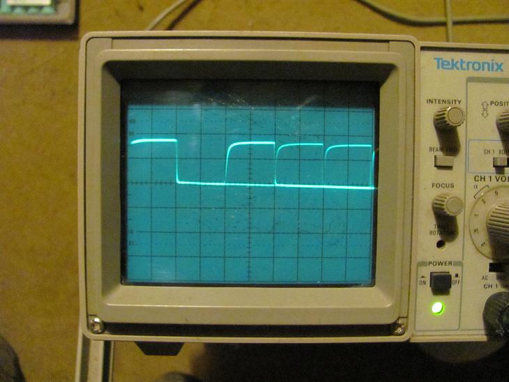

This is the Phase 1 clock at pin 3
I should ( but I can't hold them ) use 2 probes to capture both of them and see how the phase relationship is.
Finally this is the SYNCH pin at 7, for the first time ever "seeing something" yet after a couple of reset this is normally stuck to '1', sometime at '0'.
Now .. checking the diagram, the clock seems to enter in my case UA0 ( I think it should be '10' but is really a '0' ) pin 9, which is a 7417.
There was some "rot" around that chip but I cleared it well before to start all this.
Bit odd that phase 1 and phase 2 clock is it ?

Very odd waveforms because Phase 1 is not connected to anything and Phase 2 is buffered by A10 with no other loads. I would think the 6502 CPU is bad except I know you tried another one. I wonder if there is some strange capacitive loading going on here??

I will take a look at that resistor R32 and the E3 multiplexer before I take out the ram en masse and
test/replace the 4116 rams.
Thanks again for the reply
GilesGoat will your programmer do 2716 and 2732 roms?
Thanks for the pointer dave_m, just as a coincidence my 16 DIP sockets have just come in the post.
I am not sure .. it's based on the "Willem Eprom" 097ja , I think it requires a "PCB3" version ( mine isn't ) for that type of Eprom .. I got in on Ebay long ago from somewhere in China ...
