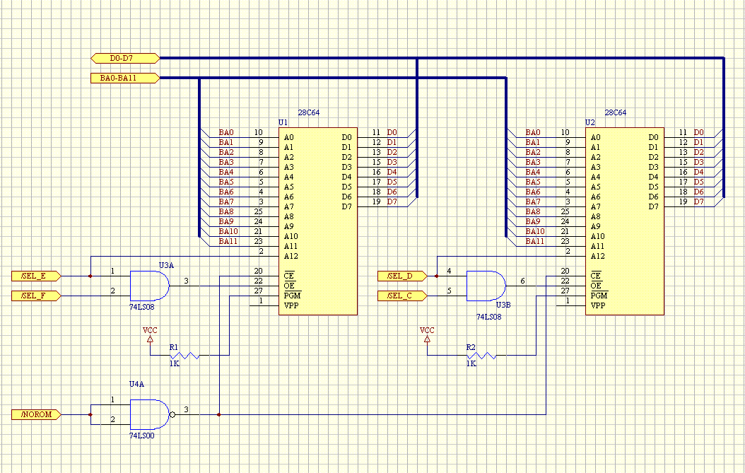

Ok, connect pins 26,27,28,30 and 32 to pin 8, and pins 29,31 and 33 to pin 1. How's that, smart a$$ ? (Big ;-) )
This is going to be my "weekend idea" to sort out the ROM problems.
Maybe "a bit excessive" ? ( ok I could maybe replace that 74LS00 with a 2N2222 and some little extra ).
Untested, unbuilt ( yet ) .. developed over a cup of tea.
Nice; what did you use to draw that?
I don't think you have to worry about /NOROM unless you're a stickler; AFAIK only the SuperPET uses it.
But you do have to disable the upper half of the E ROM space because that's where the I/O chips live.
Let's test the ROMs first ;-)
Never mind! I just looked at the schematic and it looks like the entire E ROM is enabled but the upper half is taken off the bus by turning off the buffers when I/O is called for, so no problem, E800-EFFF ROM data is never on the bus; on some other models the ROM itself is disabled in that space.
Mike,
No, you were right in the first place about needing to disable any EPROM in the E800 to EFFF memory space in the 3032 or earlier PETS or it will clash with the I/O devices. The ROM data lines (and RAM) are not buffered but are connected directly to the CPU bus.
I learned that the hard way with Stéphane's PET when I sent him a 2532 rather than a 2516 for the E000 ROM. In fact you and Anders are the guys that spotted the problem. :)
