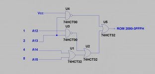

Ok so you're ROM and RAM chip will have chip enable pins, this is what tells the chip to turn on or off.
Remember they all share the same data bus and you do not want two chips trying to use
the data bus at the same time. This is called bus contention and will damage your chips!
So we map memory locations, with logic gates, to turn on the CE (chip enable pin) on our chips
for certain memory ranges.
The 8085 is an 8 bit computer with a 16 bit address bus, so it can address 2^16 power memory locations
(at each location is an 8 bit chunk of data).
Or that's 65,536 memory locations.
Or that's 1111 1111 1111 1111 memory locations.
Or thats 0xFFFF memory locations.
It's much easier to represent this with hexadecimal values so I will be using that for now on.
So the 8085 can address memory between 0x0000 all the way up to 0xFFFF (or 0000 0000 0000 0000 up to 1111 1111 1111 1111)
So all you have to decode 8 kilobytes of ROM and 8 kilobytes of RAM.
So you could give your ROM the location 0x0000 (starting instruction) up to 0x2000
And then RAM could have 0x4000 up to 0x6000.
Yes there is a lot of wasted space between 0x2001 up to 0x3FFF but if you only need 8KB of each then it doesn't matter.
My memory IO decoder is more complex because I didn't want to waste as much space because I have bigger ROM and RAM
chips as well as a serial UART and an IO chip to address.
For you, simply an OR gate on address line 14 (remember I am counting from 0 to 15) would turn your ROM enable on
and at 0x4000 address 14 would be logic high so then it would switch the OR gate to your RAM to be enabled.
Quite simple in your case! (Also keep in mind that chip enables are often enabled at logic low not logic high, check your data sheet).

Uhm, why do you say it should be eight kilobits? The address scheme BlackCow laid out refers to numbers of *BYTES*.
It's really simple, and it's astounding how many times in this thread this has been explained to you: The 8085 is an 8 bit CPU with a 16 bit address bus. Address circuitry decodes the ADDRESS BUS, and 16 bits gives you 65,536, aka, 64k possible address locations at which the CPU could read or write an 8 bit data word. (If you want to be pedantic I suppose that makes the 8085's total addressable memory 512 kilobits, but it's broken into 8 bit chunks and memory fetches operate on those byte-size pieces.) BlackCow's memory layout was essentially to wire an 8 kilobyte EPROM chip and an 8 kilobyte SRAM in parallel. (Each of which would have 13 address pins, A0 through A12 for 8K 8-bit bytes of ROM and RAM, respectively. And yes, they'd also have eight data pins so each would be a 64 kilobit part. The number of bits will probably be reflected in their part numbers; the 2764 was a common 8 kilobyte parallel EPROM and the 6264 is a common 8 kilobyte SRAM; but what's important for this application is how many BYTES that number of bits works out to.) Then his suggestion is to use the fifteenth address line, which would be A14 on the schematic to select which is active.
If you understand binary (which I'm not entirely sure you do), you'd understand how this works. A14 (which again, is the 15th address line) would act as an ON/OFF switch which is toggled on and off at every 16K boundary in the 64k address space. IE:
0 to 16383 == 0x0000 to 0x3FFF == 0000 0000 0000 0000 to 0011 1111 1111 1111 == A14 is off
16384 to 32767 == 0x4000 to 0x7FFF == 0100 0000 0000 0000 to 0111 1111 1111 1111 == A14 is on
32768 to 49151 == 0x8000 to 0xBFFF == 1000 0000 0000 0000 to 1011 1111 1111 1111 == A14 is off
49152 to 65535 to 0xC000 to 0xFFFF == 1100 0000 0000 0000 to 1111 1111 1111 1111 == A14 is on
(The third column is the binary representation, and the second 0 from the left represents A14.) ROM is enabled whenever A14 is off, RAM enabled whenever it is on. With addressing circuitry this simple you'll see the following:
A: If you're using 8K parts each will appear twice inside each 16K window. IE, the contents of your 8K ROM will appear where you want them at location 0000, and then appear again at 2000. The reason for this is there's no decoding of A13 the 14th address line, the one that marks off 8K boundaries) and the chip only uses address lines up to A12 (13 of them.) The state of the lower 13 address lines counts up the same whether or not the 14th is on, the chip will be enabled for the whole time up until the 15th address line comes on, so it'll just spit out the same contents whether A13 is on or off. If you were to use even smaller parts you'd see even more repeated copies, IE, 4 copies for a 4k part, 8 copies for a 2k part. If instead you used a 16k part it'd fill the window perfectly. But:
B: There are four 16K windows in the address range, so each set (off/on) will also be repeated twice. (IE, the same memory that lives at the 0k mark will also appear at the 32k mark, and ditto the 16k and 48k windows.)
If you're stuck on 8k parts and having a gap between ROM and RAM bothers you decode A13 instead of A14 instead. Then RAM starts at 0x2000, right after ROM. But now you'll have a copy of ROM at the 16k mark, RAM at the 24k mark, ROM at the 32k mark... etc, etc, so it wastes the same amount of address space, just in a different pattern. Heck, if you really think that "8 kilobits" is the right number decode A10 to use a one kilobyte (which is eight kilobits arranged into eight-bit bytes, as explained earlier) EPROM at 0x0000 and a one kilobyte SRAM at 0x0400. Then you'll have a copy of your entire memory map repeated every 2k boundary. If you don't want these shadow copies then you need to more fully decode the address spaces by adding more logic gates. And as BlackCow also noted you'll need to add some decoding hardware if you want to add any I/O chips to make this thing useful at all, unless just bit-banging the single I/O pin on the CPU is your idea of a good time.

Hi,
for selecting PROM at 2000 to 3FFFH i have designed this logic circuit, please tell will this work??
