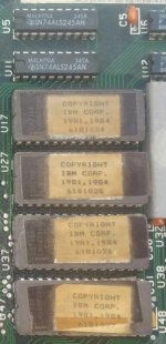

I've got junk of IBM PC 5170 type 1 motherboard.
This is very early Type 1 release of IBM PC 5170 BIOS.
Part No. : 6181024 (16KB) + 6181025 (16KB) = 6181028 (32KB) , 6181026 (16KB) + 6181027 (16KB) = 6181029 (32KB)
Good to see these chips, listed in figure 9 of the document at [here], eventually 'surface'.
Because of the 16 KB sized ROM's, we expect shunt block U131 to be in the '27128' position (per [here]).
Also expected, are Intel made 8259A interrupt controller chips.
Now that we have a photo of the ROM's, I will later add details to [here].

Sure, here it is.
