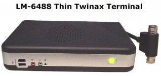

Digging around today I've actually found DoC dumps from another vendor of a similar product, a Nlynx LM-6488 twinax thin client instead of the Visara NCT coax thin client I'm trying to dump.
in the 00's, these vendors actually had downloadable updates.. on ftp sites now long gone.
FWIW, I'd be interested in finding a Nlynx LM-6488 if anyone has one they don't need. Digging on the web, there are lots of people taking these mainframe thin clients, ripping out the firmware
and PCI interface and turning them into routers or DOS boxes. These particular units are interesting in that they are running Linux and not CE or QNX like most of the others do.
