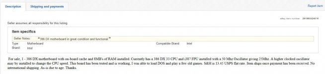

Understood. The seller described it as an Intel board, but there are no identifications on the board itself, and as I have no documentation I'm simply wondering what it is. Pic below is screen shot of listing.

I can't see anything which identifies exactly which clone 386 motherboard that is.
