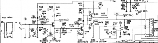

Hugo,
thanks, here is a link to a YouTube video with the effect in place: https://www.youtube.com/watch?v=R_EmN1XPpc8
Here is the same but with the screen filled so you better see the distortion (embedded in a twitter post): https://twitter.com/AkBKukU/status/1249828043289268224?s=20
Here is the link to a description and scope shots with and without, and the schematics (embedded in twitter): https://twitter.com/afachat/status/1250182893328007170?s=20
but I will attach the picture to this post as well.
Hm, schematics didn't work to attach, so here is the link to the Commodore Archive with it: http://www.zimmers.net/anonftp/pub/cbm/schematics/computers/pet/8032/321448.gif
[Edit: the scope shots are from TP2 in the schematics]
Thanks again for your help!
André
In the poke condition, the vertical yoke currents are lower than in the normal run condition with full vertical deflection. I cannot see it is likely the VDU would be in any way harmed by this event, all the currents in the vertical deflection amplifier stages are lower in the poke condition than they are normally. It would be quite different if the scan amplitude increased. So I think its hardly a "killer poke" at all.
On the other hand, if a poke was arranged to upset the H scan stages, and increased the width, for example halving the H drive frequency would do it, now that would be a killer poke.

I cannot see that as a realistic possibility ,the driver transistors, nor the output transistors will have higher than usual currents in the poke mode, in both will be significantly lower than normal I think.
For some reason I still could not get the Zimmers schematic to load. Do you have another link ?
I may be able to suggest a simple measurement to help prove the point one way or the other.
The great thing about a VDU though, if there is a visible display, it is diagnostic of many things:
The form of the scanning raster tells you about the peak currents in the deflection coils and therefore the deflection systems.
If the amplitude of the scan drops, the yoke peak currents are lower than normal and in the case of a vertical scan amplifier, that means lower in the output transistors and therefore must be lower in any driver transistors. There is the possibility though of a significant DC offset at the output amplifier being masked over by the usual AC coupling to the yoke, however, even in that case, the coupling capacitor charging has reduced the output current, in the output transistors & drivers, to a lower level than normal I would expect.
The vertical scan amplifiers are generally analog amplifiers, unlike the Horizontal scan output transistor which acts in switchmode. This is because of the nature of the load, which is dominantly inductive for the H scan coils so a rectangular voltage drive is required for the H scanning coils for a sawtooth current. However significantly resistive and inductive for the vertical coils, so they require a combination of a sawtooth voltage combined with a rectangular wave (called a Trapezoidal wave) applied to have a sawtooth current for scan and a rapid flyback for vertical retrace.
This is why vertical deflection amplifiers have can have scan linearity potentiometers that alter the analog conditions in them and the shape of the sawtooth voltage.
In H scan output stages, the linearity cannot be adjusted (as the H transistor is in switch mode and its drive wave has no effect on the scan linearity) so instead they have saturable magnetic reactors in series with the yoke and S correction capacitors to achieve a linear scan that way.

Looking at the schematic, there is no mechanism that I can see how an abnormal vertical drive signal from the computer could damage any of the transistors or components in the vertical scan amplifier & output stage. The "killer poke" is busted in my opinion. As I mentioned though, this is not the case for the Horizontal circuits and an abnormal H drive signal can cause big trouble.
