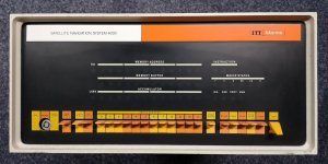

So finally I got enough money to buy a second hand satellite navigation system. Somehow I'm
a bit worried about map updates... ;) But also the satellite is probably not working any more.
I got this PDP8/L system from a man who installed and maintained these kind of systems.
When the system became obsolete he took one of these systems home. The idea was
to use it for his miniature trains. That never happened so it was waiting for 40 years in the attic.
So after navigating for the last time it was never turned on any more.
He told me that is was used on the first Satellite navigation system Transit.
https://youtu.be/yzUH5w9-O5M So I guess this is also a kind of history on its own...

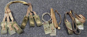

And I think these cables were used in the original ITT equipment which
belonged to the system. Unfortunately there is nothing left from the
rest of the system...

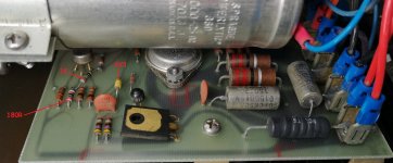

I've been slowly powering the power supply and saw the 5V line go to 6.3V and then drop back to 5.1V.
That is quite an ugly behaviour to say the least! Then I was searching for the schematic of the regulator
PCB which is not in the DEC documents. With a bit of searching on the web I found schematics from
Mattis and Anders which seem to run into the same problems.
So I'm going to modify this board as well... But I don't like the crowbar using the same voltage reference as the
power itself does. So I think I will make a little circuit next to the board with a crowbar and his own voltage reference...
The regulator board (drawn by me): https://www.pdp-9.net/docs/pdp-8-l/pdp-8l-5V-regulator-board.pdf
Hi Anders, thanks that saved me some work! :D I've changed the zener diode to 4.3V
and made a voltage divider of 1K and 180 Ohm to get the 4.3V onto the differential amplifier.
There is no overshoot any more at powering on the power. It gives 5.15V now which is great
because there will be some losses in the backplane as well...
The tripping point of the crowbar is also lowered to 6V because of the changed zener diode.
I've tested the crowbar by putting a 6.8 Ohm 10W resistor in series with the 8V line to the power.
On the 5V output I've connected a Hameg Laboratory supply set at 4V. When turning on the PDP8/L power
it lifts the Hameg voltage to 5.2V. And while slowly raising the voltage on the Hameg the crowbar trips at 6V.
This short circuits the Hameg power (which is curent limited) and it shorts the power in the PDP8/L circuit
which I also limited in current with that 6.8 Ohm resistor. So everything is working fine...
BUT... In my opinion this circuit has one huge flaw... When the zener diode goes open circuit the 5V will go to 8V.
And the crowbar will never trip because of that defective zener diode. I don't like all my TTL chips being protected
by the same component as which is also regulating the voltage.
So I've designed a little extra crowbar to put into the machine. Just in parallel of my 5V line.
When the power fails for whatever reason it will protect the few hundred TTL chips.

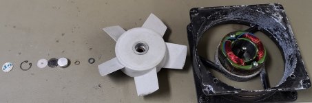

My machine did also suffer from moisture... Especially the fans were quite ugly corroded. One of them
even touched the corrosion and you could not rotate the blades... But I didn't want to replace the
original fans by some modern plastic China things... So there was only one option. Take them apart.
After sand blasting them the corrosion was gone and I could spray some new black paint on them.
And because they were open I could clean the bearing as well. The filt pad in the front of the fans
are actually oil reservoirs to lubricate the fans over the years. Off course they were completely dried out.
So I soaked them into motor oil and I put a bit of the oil on the motor shaft. They run as new now, very smooth...
I think I'm going to do the same with the fans in my PDP8/M.

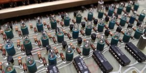

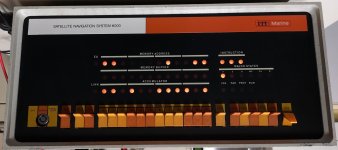

This is my first PDP which has his original light bulbs. My 8/M is a LED machine and my 8/E was upgraded to LEDs.
So I really liked to see those light bulbs. But after checking them more then 20% was end of life. I could not find these
original bulbs but the CM7371 seems to be a close match. To keep the same light output I've replaced them all...
I keep the original bulbs, maybe I find a machine in the future which have also these OL2 bulbs. Then I can fix
that machine with these originals... I've tested all the data lines and all bulbs work in dim and full brightness.

And the diode board on the core stack is affected by the decayed foam which was pushing against it...

For now I've put everything back into the machine and slowly powered it up again. No fireworks...
But I can't read or write anything into memory. Loading an address works. Depositing something
into memory shows up into the lights. But after reading back that address it reads zero on all addresses.
When I put the PDP into RUN mode it runs endless NOP operations. To be honest, the machine does a
lot more then I expected. But there is probably still a lot to do...
