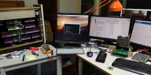

Had a recap reading my restoration blog, seams like I never used the 2N3725. I intended to use them as replacements for the DEC1008's on the G221 boards. I found the 2N3444 transistor, it's a perfect replacement for DEC1008 (MM1008). I don't have any of those left.
In the meanwhile I had some contact with Vince about the flip chip tester.
From the first moment that I got it running I started testing the boards.
The first cards which I tested were a few spare ones. The tester
works so now it was time for the real work.
The first card in my 8L was the M220 to test. If passed the tests with flying colours!
The second M220 > defect
The third M220 > defect
The fourth M220 > defect
So I began to wonder if I had damaged the tester. So I put in the first card again,
and it worked. So those other cards were really defective. That was just a bad start
and I began to worry if there would be a huge amount of TTL chips being defective
in the rest of the machine. Fortunately that was not the case...
The flip chip tester in combination with a HP logic comparator is a very powerful tool!
In the more complex boards you will find faulty chips in no-time.

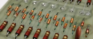

Besides defective TTL chips I had to replace a huge amount of diodes.
Due rust the glass of some diodes was breaking. The result was a lot of
shorted or OC diodes.
This was also the case in the core stack. I've tested these diodes with
a Hameg HZ65 component tester. This tester is capable of pushing 250mA
RMS trough the component. While testing there were diodes which showed
a little leakage current. And after a few seconds you just saw them break down.
I know the Hameg HZ65 is also vintage and quite rare. But it is very simple to build.

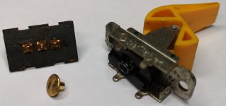

The deposit switch was giving problems. There was some dried out grease in it.
After cleaning the switch worked fine.

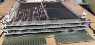

I didn't trust this behaviour, so I checked the core stack diodes again. Guess what...
Another 32 diodes broke down...! Most of them short circuiting...
These things are really horrible in this machine. :?
I had to change many diodes and they broke down after a while. So the memory broke down over and over again.
One interesting thing was that I only had to change diodes on one of the diode boards. When I measured the forward diode drop voltage it differed between the boards so I guess that the boards where populated with different diode models or diodes for different batches.
That is the reason why I replaced all the diodes on the other boards if I
found several defective ones on a single board.
I guess I was a bit naive to think that the core stack would be different. There are now more
than 70 defective diodes of the 512 total on the stack. In the first place I replaced only
the broken ones... But I should have replaced them all in the first place.
So I did a bit of soldering today. The G611 has 256 brand new diodes on it now :D
I've ordered some more diodes to do the other board as well... Maybe a bit crude...
But I don't like to reopen the system once in a week if another diode breaks down again...

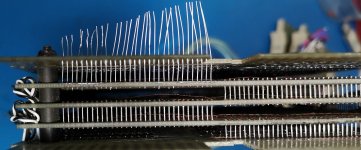

Happy new year! :D I've replaced all 512 diodes on the core stack, 256 diodes on both sides.
The replaced diode counter is now on 718... Checked all X, Y, sense and inhibit wires.
No problems here and memory runs flawless on 22.5V now!
