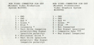

Where did you find that tech note? On bitsavers? It might help me solve a mystery. When I got my two other models of Mindset - the Video Production System and the Professional Video Graphics system, I was getting zero out of them on power up.. just the fan - a solid blue screen on RGB for one and nothing on the other, and nothing on composite for both. I discovered the LO BIOS roms matched the LO BIOS EPROM in my working Mindset, but the HI did not. So I burned two EPROMs with the correct HI BIOS info, and suddenly they were both starting up. I don't know if BIOS can change the RGB output type.. I'd assume not. Just wondering if that was my original problem. The VPS works fine for both RGB and composite, but the PVGS does not - composite is perfect, but RGB, the horizontal sync seems to be messed up. You can make out bits of what should be the output but it doesn't assemble properly into an image. I've tried a couple different RGB monitors and settings but nothing worked. I thought maybe the PVGS was using a different frequency than standard or the 640x400 mode just doesn't work with my monitors. But I wonder if maybe it's putting out analog? I would think i wouldn't get anything though, or worse. I have that Taxan monitor, and someone was kind enough to send me a cable for it.. if the PVGS is putting out analog I might try that as the cable is for one of the analog ports.
Okay - I get confused about analog and RGB. I dug around on bitsavers and found this about the pinouts on the VPS and the PVGS:
The VPS looks like what I'd expect for digital RGB. but the PVGS on the right looks quite different.
This comes from this Application note. I'm wondering if this different pinout is the source of my issue syncing the PVGS properly.
Ah... I see my mistake with the Taxan. I don't think it actually does anything but digital RGB.. I thought the Apple II mode implied analog, which is what I think the Apple RGB card uses. But this was set up for the Taxan RGBII card you can install in an Apple II, which is digital.

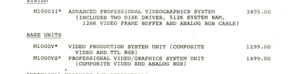

This is the tech note I was referring to and, yeah, the PVGS, if this note is to be believed, takes a completely different RGB monitor than the plain Mindset. The double asterisks next to the R-B-G signals are explained as indicating a “1v peak” analog signal, and it’s also chucking out composite sync instead of separate H/V.
If this note is correct the apropos monitor for this system would be an NTSC frequency analog RGB monitor like the Commodore 1084 set up to work with an Amiga.
They did mention the Zenith ZVM-135 somewhere. I have one of those and IIRC it does both digital and analog RGB. Weird that they'd do that though with one machine. But it may explain the larger daughter board in the RGB port area.
I would hazard a guess that what the analog output on the PVS does is take the nine bits that are usually used for the Composite palette and slap a three bit DAC in front of each color group and pump it out the back. The probable reason they use composite sync is because it looks at least like the PVS supports RGB overlay, which means getting sync off the genlock feed.
