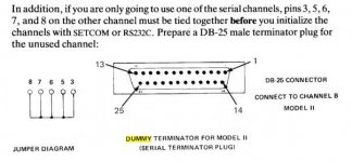

Also, are you using the Dummy Terminator on the unused serial port? This is required as per the Model 2 DOS Reference Manual.

What??
I tried with Port B as well. No difference. Am beginning to think griffk is onto something. I do have the transfer client on there, and I will be looking at its source to see what it does explicitly for handshake (it doesn't work but may serve as a guide). But I would have thought that, having set the port options in SETUP.COM, all programs - in particular PIP as it is part of CPM - should honour them. Otherwise what is the point of a global settings application!
