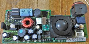

Today, I’ve got my FMA3300 and wanted to share the PSU data.
Dos and Win3.1 is installed. If you need something, I could provide that too.

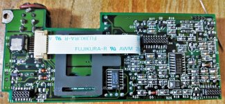

I also have one of these FMA3300 laptops (386DX40 by German brand Highscreen, purchased around 1994).
My battery also leaked and destroyed quite a few vias and traces. I did an extensive repair work which included unsoldering the resistance networks on the bottom side and wiring damaged vias directly, but at the end the laptop did not boot. With the second mainboard I did the same, but also without success yet.
@ferrytale: Maybe we can collaborate. Except the unlikely case that the three available mainboards have all the same defective connection, we could share information about connections. My idea would be to number all vias in the vicinity of the NiCd battery and to find all connections to and fro. Which is a terribly time-consuming job, of course, but winter is coming :) But doing this with two or even three mainboards should reveal the missing connections.
Question: How do you know that the VGA card is the culprit? Is there any diagnostics code that one can read out during boot?
BTW, my observation is that the LCD backlight does not start up, which means that it must be switched actively by the BIOS. It starts when I pull the PSU PCB off, and I found that one of the connectors turns the backlight off when I connect it to ground via 47R.
@i8088: As I believe my PSU is still OK, I have measured the voltages.
If you look from the upper side (where the LEDs look at you) and identify TP3, the pinout in the first row is (from left (TP3) to the right (4x green LEDs))
1: +5V
2: GND
3: GND
4: switches LED #2 on when pulled to ground
5: switches LED #4 on when pulled to ground
6: switches back light off when pulled to ground
7: 5V
8: -13.5V (rather weak, depends on current; maybe for RS232?)
In the row below it is:
1: switches LED #1 on when pulled to ground
2: 5V
3: GND
4: unknown, goes to TP3
5: switches LED #3 on when pulled to ground
6: unknown
7: +12V (maybe for RS232?)
8: GND

If you dont mind, can you please check whether CN3 and CN4 connectors in the notebook's internal power supply are connected to the screen and CN6 is connected to the videocard in your notebook?
