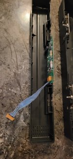

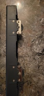

If you dont mind, can you please check whether CN3 and CN4 connectors in the notebook's internal power supply are connected to the screen and CN6 is connected to the videocard in your notebook?

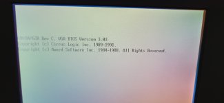

Hi, I've come home tonight, I way playing with my laptop and it froze and now won't boot, it just hangs here. I think I am going to give up because I seem to fix one thing and something else breaks. I'm tempted to strip and sell, do you want to buy my keyboard?
All three are connected to the screen. When I took my laptop apart earlier today I didn't disconnect any of these three. I only disconnected like an earth on the video card and the video ribbon and I could then totally seperate the screen (still connected) and the power supply board from everything else.

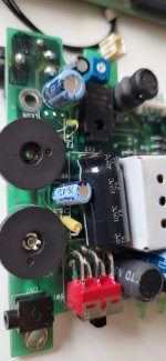

At the weekend I noticed that when I switched on my 3500 (monochrome) the screen flickered like mad. I managed to adjust the brightness and contrast so the flicker was bearable and then after about 5 mins it was gone so didn't think anything about it. Monday, Tuesday all was fine. Yesterday the flicker was back, again for a few mins. Depending on how the brightness and contrast is set the flicker is literally as if the screen is off and on, not just a mild wave. As I say you can adjust the brightness and contrast so the flicker isn't so bad and then stops.
Anyone else had this? I'm worried it might get worse and worse. If it does I'll have to scrap it for spared.
That sounds like dead caps. There must be voltage drops. Time to replace them.
Solved now, a piece of loose solder was left and had jumped onto the motherboard!!!

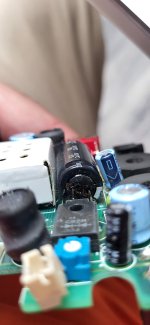

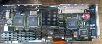

I bet its this one. It was about 1mm above the leaking battery.
You can check all caps with a cheap measurement tool from Ali express or replace all of them with good new ones.
I "think" the cap is OK. I've washed all the gunk off with White Vinegar , and will observe to see if the flashing ever comes back.

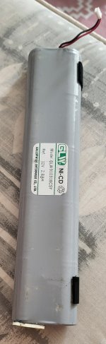

The last job to do in restoration for me is the main battery. Its 2x5 Full Size NiCd C Cells. Full size C Cells are almost impossible to find singular. However you could use Sub C's or 4/5 Sub C's. I've found somewhere in the UK that supplies a 5 cell stick for £17. I'm looking to buy 2, however the company is asking the supplier if they will make me a 10 cell stick.
I've included pictures incase they are helpful to others.

I've been doing more digging on the batteries for these. I think I found some useful information cross referencing your battery number#
It seems most of the batteries intended for these laptop's (FMA3300, FMA3500/C/SX, FMA3540) battery casings is also sold as a LAP-220 battery pack. - https://www.batterytex.com/browse/manufacturer/klh - made by KLH apparently.

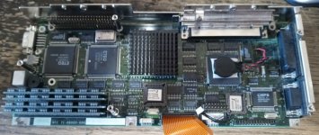

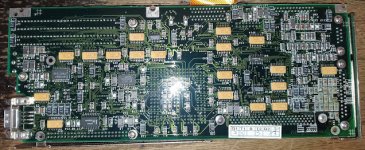

Anyway, I took some Gut Shots of my own NanTan FMA3500C/BSi 486DX/33 Notebook this afternoon. I finally replaced the CMOS battery with one from a Dell Latitude E-series. It seems to work great. Right now it's idling on my desk.FMA

The pictures don't do justice. One whole side of the Varta Battery was covered in white/tan corrosion, and a group of surface mount diodes/caps/resistors seem to have been hit as well. The battery only read 0.16vdc so it probably started leaking out once already dead. I sold my GEM 286 desktop that also had a (just barely) leaky Varta and it was still working after 33 years of faithful service somehow (!?!?). I don't think these computers always recharged the CMOS battery even if they had one capable of it. I know my 9200 sure does - and it uses a Lithium Ion coin cell. Since I've been running that on the regular it's not lost it's settings, but when I first got it, I could not remember it's CMOS settings to save it's life. I cleaned the area with Mass Airflow Sensor cleaner

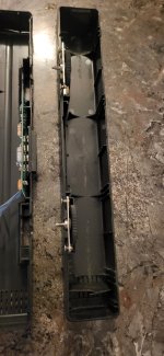

I am already to rebuild my external battery. 4 screws to undo. Saved the cable from the original Ni-Cd to then solder onto a new pack. I did have the option of buying a 10 C Cell wrapped just like the original, but I have gone for 2x 5 C Cells because then I can replace half the pack if needed later on.
I paid £40 Inc delivery (UK).
These batteries are fairly easy to source if you search for "Emergency Lighting Batteries". See screenshot.
The original pack came with C Cells. Obviously Sub C and 4/5 Sub C will be suitable also. But don't buy D Cells, they will be too big.
Can't wait to finish the restore!
To recap, work done so far:
1) Replaced leaking Ni-Cd CMOS battery.
2) Cleaned away leaked Ni-CD from both the board it was attached to, but also the board
above. I had leakage over the legs of a capacitor which was causing screen flicker intermittently. I used white vinegar to clean.
